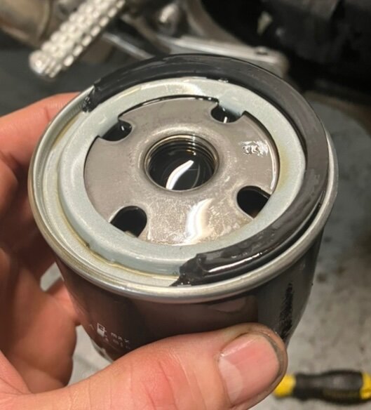

Jake Posted January 10, 2023 Author Posted January 10, 2023 I think I may have found the problem… 3 1 2
Jake Posted January 10, 2023 Author Posted January 10, 2023 The other half of the seal dropped out of the case about a minute after I removed the filter. I’ve a new filter on hand so I’ll chuck that in and hopefully that’s that… 1
80CX100 Posted January 11, 2023 Posted January 11, 2023 1 hour ago, Jake said: I think I may have found the problem… That's nasty looking. You're very lucky that didn't happen unnoticed on a long ride. What type of filter is it? I've never experienced problems with them myself(Other than whole gaskets coming off and being left behind out of sight) but I've read lots of negative comments on UFIs fwiw 1
MartyNZ Posted January 11, 2023 Posted January 11, 2023 Did you lubricate the seal with new oil before you fitted the new filter? It lets you tighten the filter without tearing the seal. 3
Jake Posted January 11, 2023 Author Posted January 11, 2023 Yeah I always smear a bit of oil on the ring as I install it. The filter was Mahle… not sure how or why the ring would split like that in situ but there you go 🤷
