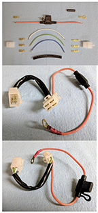

docc Posted January 12, 2023 Posted January 12, 2023 2 hours ago, LaGrasta said: from my notes: MPH Cycles Starter Interruptus mod Parts at http://www.cycleterminal.com/ (except the 14 AWG blue, green and white wires). The MPH Cycles part comes with a 10amp fuse in the fuse link. blob:https://www.v11lemans.com/37737215-e75a-4437-b772-db940d46dd91 The heat shrink tubing and the black protective tubing could be replaced by ordinary electrical tape. You need a crimping tool for the brass terminals, but a garden variety tool from the hardware store will do fine. The connectors from Cycle Terminal come with male and female spade terminals. The "eye" terminal on the fuse link has to be purchased separately. blob:https://www.v11lemans.com/08e918e2-df27-40b2-ace8-2441e33b4cf9blob:https://www.v11lemans.com/16386789-331d-4dc4-b15f-3a6be25cae02 3 minutes ago, Speedfrog said: @LaGrasta those links to V11LM threads you posted don't work.. I tried to fix that, but couldn't . . . 2

LaGrasta Posted January 12, 2023 Posted January 12, 2023 sorry about the image links, this site limits us. I don't host images on another site, so I have to Photoshop them to 200k.
docc Posted January 12, 2023 Posted January 12, 2023 49 minutes ago, LaGrasta said: sorry about the image links, this site limits us. I don't host images on another site, so I have to Photoshop them to 200k. A bit tricky to post existing Gallery images to a new post: "Right click" the thumbnail in the album and select "Copy Image Link" and the image will paste and display. Attempting this from the image, itself, is not an option.
al_roethlisberger Posted March 9, 2023 Posted March 9, 2023 On 1/11/2023 at 5:45 PM, LaGrasta said: from my notes: MPH Cycles Starter Interruptus mod Parts at http://www.cycleterminal.com/ (except the 14 AWG blue, green and white wires). The MPH Cycles part comes with a 10amp fuse in the fuse link. The heat shrink tubing and the black protective tubing could be replaced by ordinary electrical tape. You need a crimping tool for the brass terminals, but a garden variety tool from the hardware store will do fine. The connectors from Cycle Terminal come with male and female spade terminals. The "eye" terminal on the fuse link has to be purchased separately. Do we know if the MPH Cycles unit fits the V11 Sport/Lemans? https://mphcycles.com/starter-relay-fix-kit/ If your Breva 750, 1100, 1200 , Norge 1100, 1200, or Griso sometimes makes a click from under the seat when you want the motor to make a roar, you need our Starter Relay fix kit. It solves a design deficiency and is easy to install, 5 minutes for the average owner and it works ! Their description and the various comments aren't clear if it will. I may just drop them an email.

al_roethlisberger Posted March 10, 2023 Posted March 10, 2023 An update from MPH regarding their "Startus Interruptus" kit, specifically for the V11 Sport/Lemans: https://mphcycles.com/starter-relay-fix-kit/ Quote The Kits on the website are only for Breva, Norge and Griso models. We developed an entirely different kit for the earlier bikes V11 Sports / LeMans, V10 Centauro late last year but it is not advertised on our site. Cost for this Kit is $70.00 which includes postage within USA. They are currently out of the V11 kit, and need to order relays to build more, but are in the process of doing so if anyone is interested. 3
docc Posted March 10, 2023 Posted March 10, 2023 3 minutes ago, al_roethlisberger said: An update from MPH regarding their "Startus Interruptus" kit, specifically for the V11 Sport/Lemans: https://mphcycles.com/starter-relay-fix-kit/ They are currently out of the V11 kit, and need to order relays to build more, but are in the process of doing so if anyone is interested. V11 owners, note: This concern applies to V11 harnesses from 2002, and from 2003-2005. The early (1999-2001) Sport and Rosso Mandello already use a relay and do not benefit from this improvement. They do, however, benefit from a High Current relay in the #1/Start position. 2
docc Posted March 10, 2023 Posted March 10, 2023 1 hour ago, docc said: V11 owners, note: This concern applies to V11 harnesses from 2002, and from 2003-2005. The early (1999-2001) Sport and Rosso Mandello already use a relay and do not benefit from this improvement. They do, however, benefit from a High Current relay in the #1/Start position. How could this be posted with such a high degree of confidence? There was enough member participation in the "Livin' Easy Test" to draw conclusions . . . If your V11 Start Relay is "Livin' Easy", consider the Startus Interruptus mod. If your V11 fails the Livin' Easy Test? Be certain you run a quality, rated High Current relay in that #1 position (1999-2001 V11) . . . 2
