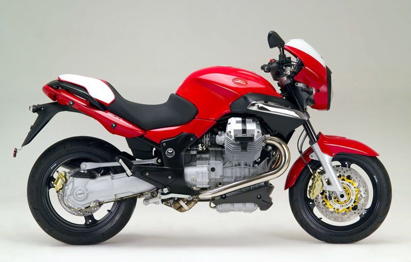

Icenian Posted January 16, 2023 Author Posted January 16, 2023 Right, OK, so "buy all of them" seems to win Thanks for the views! An entertaining read. The Le Mans vs. Ballabio comments are interesting. I probably wouldn't have considered the Ballabio, but the Le Mans is in the worst condition of all the bikes I have looked at. Nothing that needs fixing, but lots flaking engine paint and fasteners, brackets etc. that are corroding. It would be lots of work to go through everything. Also availability of specific Le Mans parts like the fairing could be an issue, whereas the Ballabio is closer to other naked/handlebar-mounted fairing V11 models -- I would be less upset about doing that to a Ballabio than losing one of the things that makes the Le Mans so distinctive. 1
Icenian Posted January 16, 2023 Author Posted January 16, 2023 BTW, comparing a 1200 Sport to a Griso, and I right in thinking the riding position is actually pretty similar? At first glance they look like totally different types of bike, but having sat on a Griso (have only actually ridden the 1200 Sport) it seemed more like a sports bike than I had expected. In particular, the bars seemed low enough that the absemce of a fairing would be fine. It's one of the ironies of bike design that if you don't get a fairing to keep the wind off, the designer seems to think you want to sit upright. To me, the less wind protection you have, the lower the bars want to be. I had one of the early model (T300) Speed Triples and loved it. Would be too radical for me now, but clip-ons below the top yoke and no fairing were a great combination for me. If I had had the Daytona with the same riding position but a large fairing I think it would have crippled me! 1

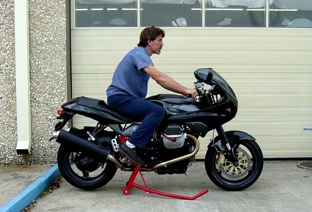

Joe Posted January 16, 2023 Posted January 16, 2023 If you are looking for a vintage Guzzi with a handlebar, then its the Ballabio, the 1200 sport/Griso if you want the carc version. The original T300 was a top heavy spine framed bike w clip-ons, which would be similar to the V11 Sport variants. I'm getting older also and decided to put a MPH bar riser kit on my V11 Sport Rosso Mandello, its perfect all day comfort for me, something to consider.

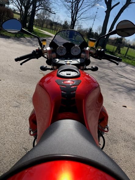

Joe Posted January 16, 2023 Posted January 16, 2023 6 minutes ago, Icenian said: Rosso Mandello with higher bars must be pretty close to the Ballabio (but with a nicer fairing set up)... Icenian, you could do this to V11 Sport early models. https://mphcycles.com/handle-bar-risers/ 2 1

Guzzi-in-Vancouver Posted January 16, 2023 Posted January 16, 2023 2 hours ago, Joe said: https://mphcycles.com/handle-bar-risers/ Joe, What kit is it in your pictures? Is it from mph? On the mph page they seem to only be selling a kit for handlebars, and not for clipons. 2

GuzziMoto Posted January 16, 2023 Posted January 16, 2023 I rode a 1200 Sport, and compared to my Griso or the wife's V11 Sport it was something of a marshmallow. Too soft for my tastes, not precise enough. Also, the seat was not comfortable after 30 minutes. But you do you. Go with the one that floats your boat. A bike can always be fixed up if in poorer shape. And it can even be customized to suit. We replaced the clip-ons the wife's V11 sport came with (ironically) a set of Ballabio handlebars. Drill out the stock triple clamp and the Ballabio bar mounts bolt right up. 1

Joe Posted January 16, 2023 Posted January 16, 2023 6 hours ago, Guzzi-in-Vancouver said: Joe, What kit is it in your pictures? Is it from mph? On the mph page they seem to only be selling a kit for handlebars, and not for clipons. It’s for the clipons.
