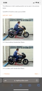

Joe Posted January 16, 2023 Posted January 16, 2023 Just now, docc said: What are we looking at on the this LeMans? This may explain it better Docc…but poor image screen shot then reducing the actual size to fit 1
audiomick Posted January 16, 2023 Posted January 16, 2023 I'm afraid the screenshot is not much use, Joe.
Speedfrog Posted January 16, 2023 Posted January 16, 2023 Here, that’ll explain it forya: https://mphcycles.com/handle-bar-risers/ 2
Joe Posted January 17, 2023 Posted January 17, 2023 1 hour ago, audiomick said: Ahhh, much better. Thanks. More upright riding position, even for the Lemans ☑️
audiomick Posted January 17, 2023 Posted January 17, 2023 8 minutes ago, Joe said: More upright riding position... I always did prefer a slightly more stretched riding position. UJM (universal japanes motorcyle) position was never my favourite. And then there is the expression that one hears here and there in Germany: "Wer schön sein will, muss leiden" Translation: "If you want to look good, you have to suffer". 2 4
