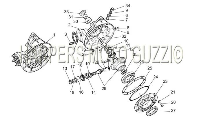

Joe Posted January 21, 2023 Posted January 21, 2023 I agree with 80CX100 about Jim Hamlin @ Hamlin Cycles in CT, he is a top notch guy. He sells used Guzzi's my guess is he can work on V11 Lemans. As for parts or special tools, you may consider Curtis at Harpers Moto Guzzi. https://www.harpermoto.com/ https://www.harpermoto.com/parts-lookup/2000-2009-moto-guzzis/v-11-le-mans-1100-2002/transmission-complete-ii/ 2 1

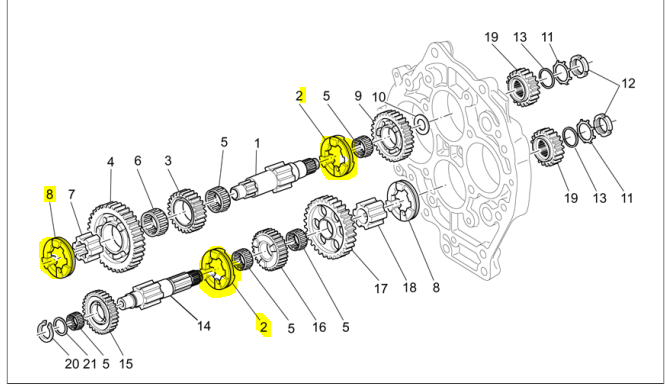

gstallons Posted January 21, 2023 Posted January 21, 2023 The gearbox Joe had pictured looks like the way to go ! You get in there and things could get out of hand quick .When you do get it going , fill w/new fluid , ride it 100 mi. and drain / refill. Examine the fluid to see what it looks like . 3
guzziart Posted January 21, 2023 Posted January 21, 2023 On 1/21/2023 at 6:24 PM, gstallons said: The gearbox Joe had pictured looks like the way to go ! You get in there and things could get out of hand quick .When you do get it going , fill w/new fluid , ride it 100 mi. and drain / refill. Examine the fluid to see what it looks like . Expand And, then there's the recommended "updates" ...indestructible shift spring, etc. 1
