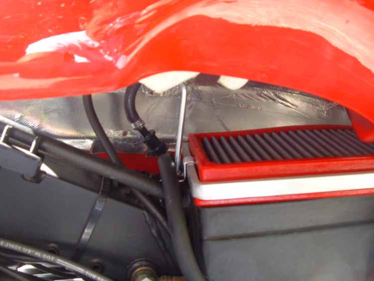

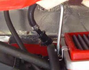

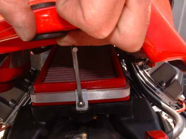

F344 Posted June 11, 2004 Posted June 11, 2004 I just pulled my airbox and replaced it with a Ferracci filter. I didn't have to remove the tank, but it was tight work. Here are some photos. Frank
F344 Posted June 11, 2004 Posted June 11, 2004 I knew the FBF kit would lean the mixture. I've been having a little trouble with plug loading so I was interested in quantifying the leaner mixture. I have a temp gun thermal reader (from tempgun.com) so I measured the exhaust pipe at the bottom of the arc in front of where my toes would be if I was riding the bike. I had to take the reading here because the temp was above the gun range at the head. Anyway, the results: Stock configuration at 2500 rpm lt 270 F rt 297 F w/ FBF airbox at 2500 rpm lt 322 F rt 336 F These numbers in the absolute of course mean nothing. But the 40 to 50 F increase in egt means a fair bit leaner. I'll be watching my plugs to see if they run clean now. Frank
al_roethlisberger Posted June 11, 2004 Posted June 11, 2004 Hey, and there's the infamous "tip over valve" that a couple people have asked people to describe so they could locate it BTW, I can't believe you did this with the tank still on I hope your fingers didn't get too smashed Good report and pics
