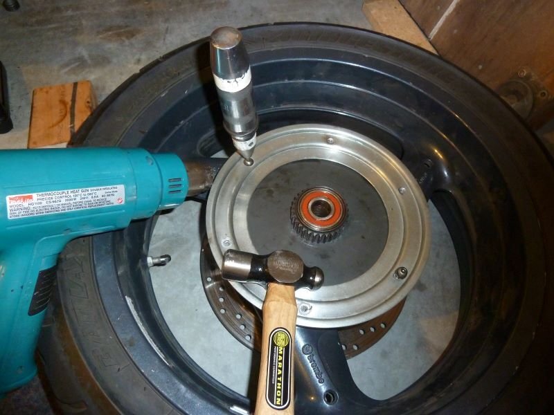

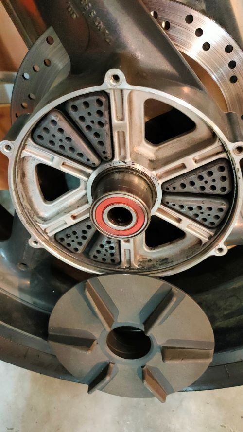

MartyNZ Posted February 19, 2023 Posted February 19, 2023 6 hours ago, Janusz said: So I've removed wheels to have new tires installed at the shop. Should I disassemble the rear wheel and remove cush drive rubbers for tire installation and balancing or take the whole wheel to the shop? I would like to inspect/grease etc cush drive rubbers but it seems difficult to me and the factory shop manual is not very helpful. It wants me to: "Working on the opposite side remove the bearing and then lift the plate with gearing (do they mean spline drive??) using two screwdrivers." Could somebody walk me through this using simple explanation please? I'd say "don't disassemble the wheel & cush assembly" The tire can be changed as it is. Also don't lose the bush that goes on the axle between the wheel and the bevel box. It's needed to get bearing preloads right. If you're like me and can't help pulling it apart, then the following pictures may help. The retaining plate screws are likely to be frozen. Heat and penetrating oil are your friends. How hot, you ask? Well the rear disk can be red hot without other damage, but 60°C would be safe. Then you can lift the splined plate out. 2 1

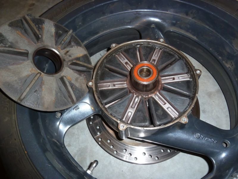

MartyNZ Posted February 19, 2023 Posted February 19, 2023 Then you can see 12 rubber pucks in recesses in the wheel hub. Some people grease the recesses and the non-metallic ring. I coated these with moly dry lube spray. You can see that I fitted only half of the pucks in my bike, and they were drilled to be more squishy. As you assemble, check that the O-ring is good, and there is wheel bearing grease on the spline plate bore. Before you refit the wheel, put a good layer of spline grease like Staburags NBU 30 PTM on the splines at the connection to the bevel box. 3 1
