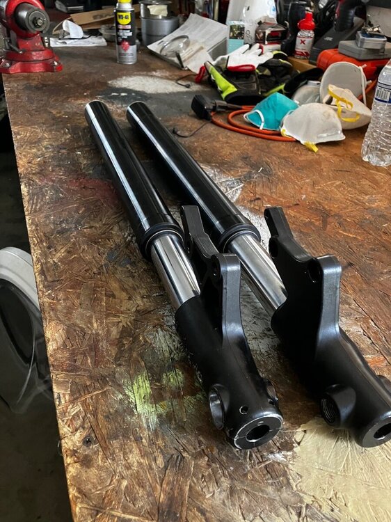

LaGrasta Posted May 29, 2024 Posted May 29, 2024 From Andreani's notes, on my install: This fork was on a 2003 Moto Guzzi V11. Marzochi 40mm inverted. All measurements were the same as 105/G08e.

Meinolf Posted June 4, 2024 Posted June 4, 2024 On 5/30/2024 at 7:48 AM, Meinolf said: Gentlemen, I'll post an update once the set is installed. Hi, this is going to be a quick one. A leaking fork seal in the left fork was the reason I started looking into the cartridge topic in the first place. I ordered the cartridge from an Italien dealership last Friday and today, 4 days later they arrived. Getting the fork seal out proved the biggest challenge in the whole enterprise, the spring ring to secure the fork seal used is a nightmare to get out. Finally I ground a small groove into the material and got the leverage needed. What a crazy spring ring selection, looks like a custom made part only for Guzzi. The Andreani kit installation was totally straightforward. Remove the original cartridge, install the new cartridge, fill oil up to specified level and done. I took a quick spin and the fork forked :-) Not optimal yet, but it felt less bumpy than the OEM. During the next days I'll adjust the settings and see if the investment was worthwhile. Cheers Meinolf 4
