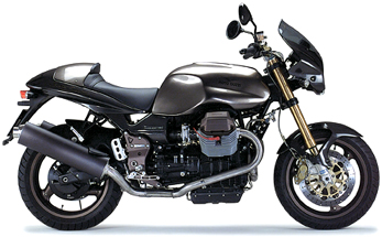

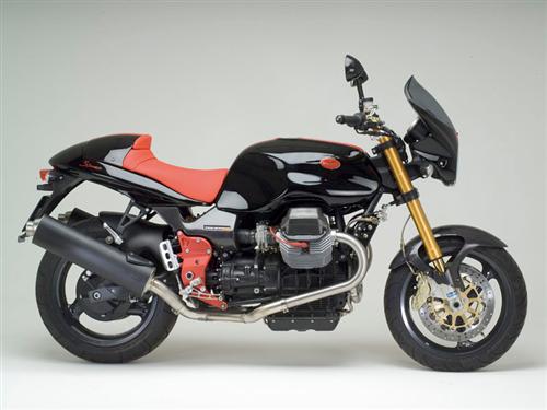

Scura R Posted March 13, 2023 Posted March 13, 2023 I could be interested in mounting a Le Mans fairing on my Scura R 2005( if I can find one for sale). The Scura R is technically identical to Cafe Sport and Coppa Italia. Will the fitting be relatively easy? Can I keep the 2005 dash? I have seen a Coppa Italia with Le Mans fairing somewhere, so I know it`s done. But can I use any year model? Tried to find this topic, and sorry if it already exists. 1
KINDOY2 Posted March 13, 2023 Posted March 13, 2023 "The Scura R is technically identical to Cafe Sport and Coppa Italia" Not sure what you mean by that........
docc Posted March 13, 2023 Posted March 13, 2023 53 minutes ago, KINDOY2 said: "The Scura R is technically identical to Cafe Sport and Coppa Italia" Not sure what you mean by that........ The way the headlamp and instruments are mounted to the Scura-R is the same as the frame mounted set-up of the Café Sport, Coppa Italia, and Ballabio. Other than the matter of mounting the LeMans fairing and mating up to the headlamp/instruments, I wonder about clearance for the handlebars (versus the LeMans' clip-ons) . . . 2
