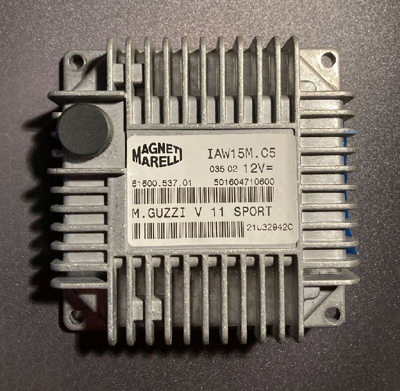

al_roethlisberger Posted March 19, 2023 Posted March 19, 2023 I have one, but not sure if it is for/from a V11 Sport, and not sure what state it is in. I'll have to go look in the garage to see what model # it is. I bought it from somewhere, probably 10+ years ago, so have no real idea.. I was keeping it to at some point copy the configuration from my TLM tuned-for-dual-plugged-heads-15M (ignition retarded, that's it) to this other 15M as a spare in case I ever fried the TLM unit If it is helpful, I'm happy to loan it. 1 1
al_roethlisberger Posted March 19, 2023 Posted March 19, 2023 OK, this is what I have that could be loaned... 4
docc Posted March 19, 2023 Author Posted March 19, 2023 2 minutes ago, al_roethlisberger said: OK, this is what I have that could be loaned... So very generous. Carries the original 2002 map?
al_roethlisberger Posted March 19, 2023 Posted March 19, 2023 17 minutes ago, docc said: So very generous. Carries the original 2002 map? I honestly don't know... I got it "used" at some point. But it says "V11 Sport" on it, and back then none of us were remapping the ECU as far as I know So I think it should have a valid normal V11 Sport map on it, from what year I'm not sure. Can we tell the model year from the numbers on the ECU? P.S. Once I completely familiarize myself with GuzziDiag and EEPROM reader/writer, I'll likely be asking for help from the experts if/how I can clone (copy) both the fuel and ignition maps from my TLM modified ECU to this one as a backup. It seems clear so far from my partial reading the various GuzziDiag threads that the fuel map can (is typically) what is copied, but it isn't clear to me if that includes the ignition map as well. 2
