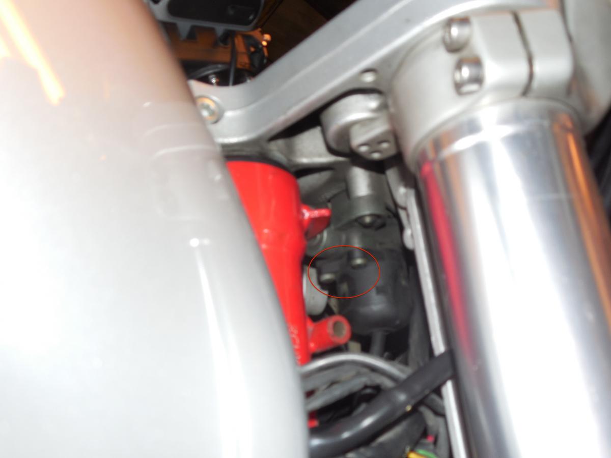

docc Posted March 26, 2023 Share Posted March 26, 2023 For certain the battery is holding up to the repeated start attempts? Regarding the ignition switch, look at that blurry image I posted above. It shows the two cross-head screws that hold the switch in place from below. Removing them will separate the switch from the lock mechanism. The switch can be opened by prying the catch tabs over the white nibs and the contacts exposed to be cleaned and treated, as well as inspecting the wiring for strain damage. Stand by, I'll fetch up a thread with images . . . 2 Link to comment Share on other sites More sharing options...
radguzzi Posted March 26, 2023 Author Share Posted March 26, 2023 @docc That was a read...! Wow...! Ok, I'll pop that ignition switch out and have a peek. It makes sense that wire strain "Could" be the issue although only one time did the starter button go from clicking to starting the engine by turning the front end left to right... 1 Link to comment Share on other sites More sharing options...
