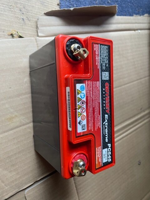

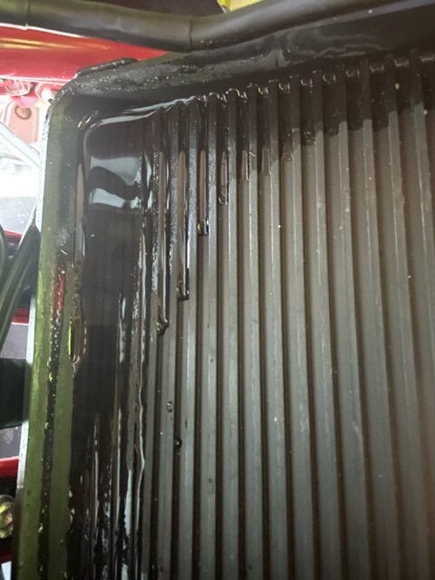

Guzzimax Posted April 21, 2023 Posted April 21, 2023 Less than 2 years since I installed an Odessey PC545 in my Greenie, i found it has been leaking Checking the bike over today, whilst getting it ready for the road after winter revealed liquid in the rubber battery tray. I can’t tell if the leak originated from a seam in the plastic casing, or the relief valve. Luckily the battery tray did its job and prevented acid dropping onto the frame, hugger etc etc Checked my other bikes over only to find the same issue with the Rosso Corsa - a leaking Odessey battery - less than 3 years old I’ve never in 40 years of riding / driving experienced a leak from a sealed battery. This has really shaken my confidence in the Odessey product. I’ve read various posts stating that the V11 charging system is tough on the battery, but also others claiming that the Odessey battery is durable & very long lived Yet I’ve another V11 still equipped with a very old Spark 500 battery still performing OK and not leaking Any thoughts before I reach out to Enersys expressing my disappointment with what has been very short lives for these 2 PC545 batteries Other suggestions of alternative brands that could be more durable? Yuasa?

audiomick Posted April 22, 2023 Posted April 22, 2023 A suggestion: I had a leaking battery once in one of my bikes. I think I probably put it down too hard, maybe on a little stone on the garage floor or something. Anyway, I confirmed the leak, a barely visible crack in the base, by simply drying off the battery thoroughly and leaving it stand in an acid resistant tray for a week or so. If you do that, and yours really have a leak in the casing, they will be at least moist after that.
Guzzimax Posted April 22, 2023 Author Posted April 22, 2023 The liquid is definitely battery acid, and they haven’t been connected to a battery tender over winter. I did some previous on line research and found this wasn’t recommended with Odyssey batteries unless it was a specific type of AGM compatible tender. They have been recharged once during winter using an Optimate 4 (which is AGM compatible) this was then disconnected when the battery was recharged (after around 1 hr) and not left on permanent standby It’s a big concern that this has occurred to 2 relatively new Odesseys whereas another bike fitted with a >12 year old Spark 500 is fine. I won’t be getting another Odessey after this experience, as my trust in the product has gone, so I guess the default choice will have to be Yuasa 1
