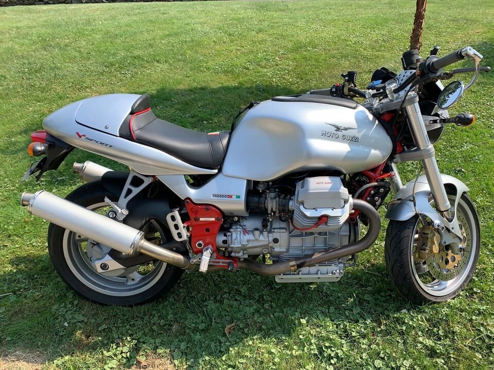

Robertguske Posted April 22, 2023 Posted April 22, 2023 Hello everyone, I'm a new member to this forum. Thanks for allowing me to join. I'm familiar with and a fan of Moto Guzzi motorcycles. I own a 1968 V700 that I'm restoring and owned a 2015 Griso that I sold a few years back (wish I hadn't sold it). I'm thinking that I'd like to get another Moto Guzzi for riding and, maybe, some longer trips (200 miles or so). There's a 2001 V11 Sport for sale in my area with 16,600 that claims to be very well cared for. Asking price is $5,900. Any thoughts or comments? Thanks! 4
docc Posted April 22, 2023 Posted April 22, 2023 Hi, @Robertguske! Welcome to the best place in the world for the care&feeding of your V11 Sport! Let me see if I can get your image to display. If you have any more images, they will help us suggest what questions to ask about the bike. Things like, "Is the VIN in the gearbox recall range?" [I see it is a facebook image, so probably cannot get it to display here ]. . . https://scontent-ord5-2.xx.fbcdn.net/v/t45.5328-4/273178129_4614528435339984_7365940288931500422_n.jpg?stp=dst-jpg_p720x720&_nc_cat=110&ccb=1-7&_nc_sid=c48759&_nc_ohc=oQRq0mW5noYAX8kHlMI&_nc_ht=scontent-ord5-2.xx&oh=00_AfDsFuixrxiKyGoVkMOktibFDS7qYd7lj0694cE10-XcFg&oe=6448F836 1
docc Posted April 22, 2023 Posted April 22, 2023 A few things I can see from the one image: Very clean surface condition, original right side brake levers intact (a good sign it has remained upright on that side, especially since there is an aftermarket headguard which, sometimes, can suggest a tip-over), original turn signals including the front "extensions, a nice custom seat that was built to retain the passenger seat cover, rear "hugger" and swingarm tips intact, tank/chin-pad and side plate eagle all look in good shape. There appears to be a period correct factory accessory Stucchi Luigi-made color-matched front flyscreen and some nice (perhaps Mistral?) exhaust canisters. The rear fender has been cut off below the license plate and the clip-ons converted to handlebars (which causes an odd throttle cable routing). For whatever reason , the clutch and front brake fluid reservoirs look painted fat black (I would prefer to see the level and condition of those fluids). [edit: those look like soft covers over the reservoirs. I am not sure why people do that.] There is some wiring hanging below the right sidecover that I would endeavor to investigate. A left side image, plus an image of the instruments. and a clear image of what is under the seat would be very helpful . . . 1

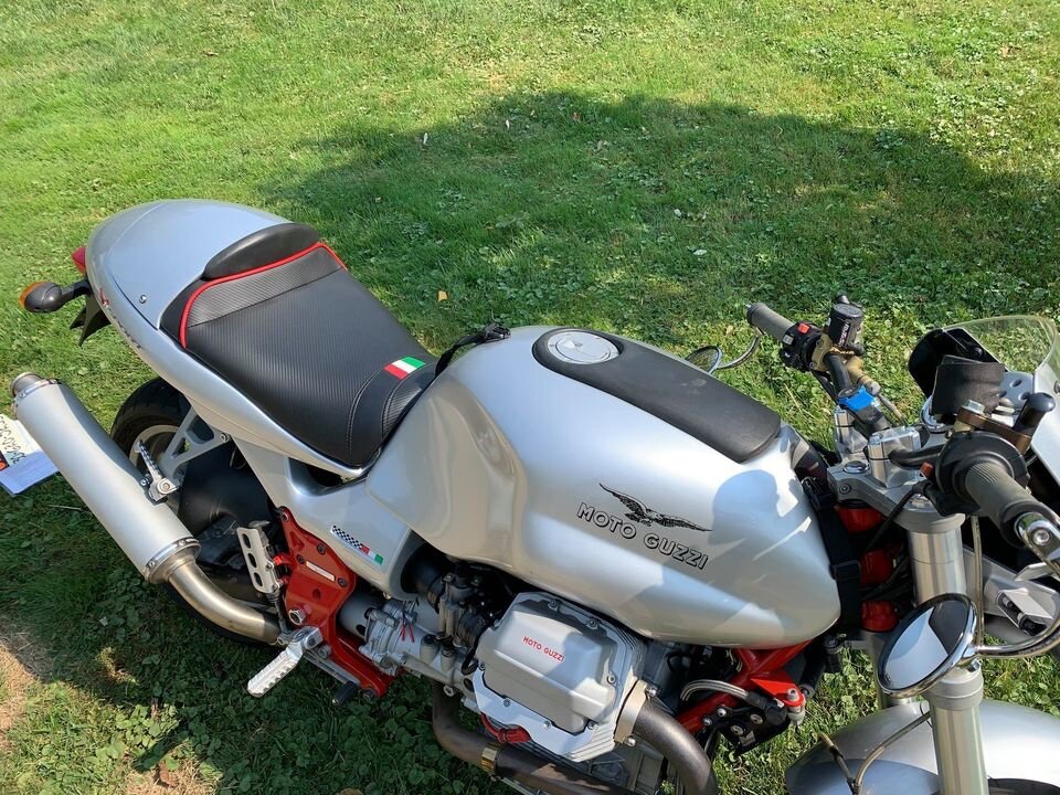

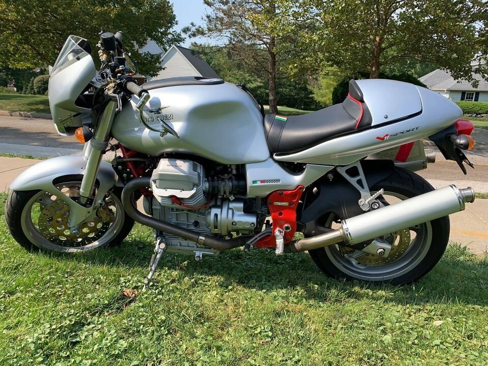

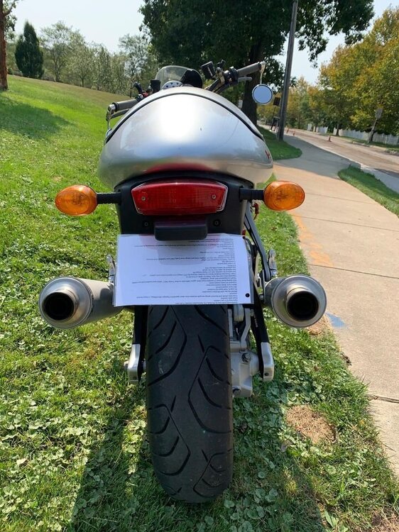

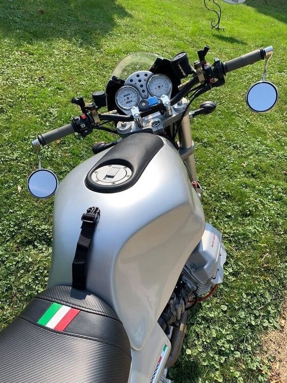

Robertguske Posted April 22, 2023 Author Posted April 22, 2023 Here are the pictures I have. I have not yet gone to look at the bike in person. Thanks. 1 1
docc Posted April 22, 2023 Posted April 22, 2023 Okay, so, that is not the period-correct factory accessory Stucchi flyscreen (not sure what that is). Left side levers are also intact along with the sideplate eagle badge. Starter cover and sidestand (wire) "lever" intact along with the sidestand "stop." Aftermarket exhaust crossover (Mistral?). The instrument needles looked completely faded out, as they would if they were original. The footpegs are a modified type with a slight "drop." Forks are raised in the triple trees (maybe ten mm?) which perhaps shows an effort to set the suspension. Eagle badge present on the top clamp (the only other to check for would be on the alternator cover). I cannot make out the shock/ spring, or even see the remote compression adjuster on the left side above the throttle. Still cannot understand the loose wires on the right that look like they have been abrading the gearbox finish. A view under the seat and service history/owner history would be good next steps. Overall, looking like a good Sport with several "changes." Call them "improvements" if they are the things you would do yourself . . . 1
audiomick Posted April 22, 2023 Posted April 22, 2023 Silly handlebars. I'm convinced that I personally would find the original clip-ons more comfortable. If not, I would still put up with the clip-ons for the sake of looking cool. 2 1
