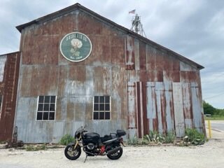

PJPR01 Posted April 23, 2023 Author Posted April 23, 2023 170 miles…really smooth and cool temp ride today. The Meinolf map is a massive improvement over the stock map I had in the bike. To be fair I don’t know with certainty that it is a stock OEM map since it’s what the bike has had since I bought it almost 7 years ago. However, this Meinolf map is deliciously smooth, can ride at 70-80 mph and no vibrations at all…power seems to come surging on between 4-7k rpm, very different from the rather flat power delivery of the prior map. Really enjoyable ride and results! 3
