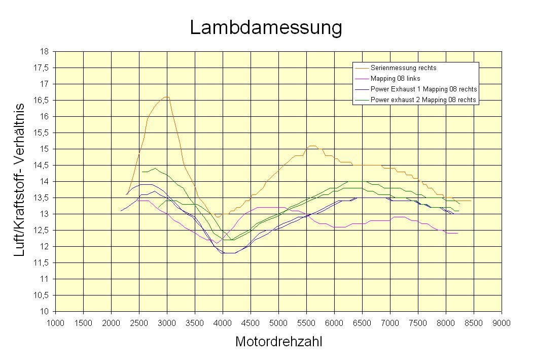

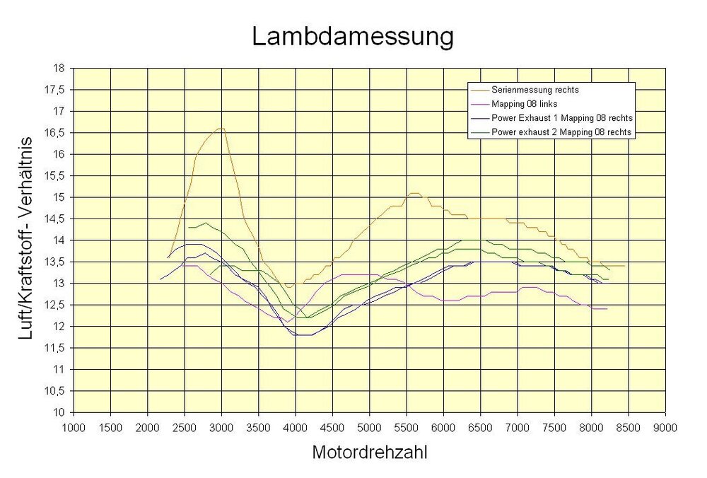

motoguzznix Posted May 11, 2023 Posted May 11, 2023 Look at the attached graph of my lambda measurements on my 2000 V11. The uppermost line is the stock bike (stock exhaust) at WOT. AFR at 2700 rpm goes leaner than 16 which is way to lean for a V11. When putting on a different exhaust, the situation may worsen easily. The lines below show the effect of my first changes on the fuel map.
