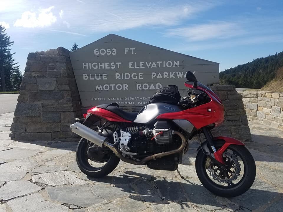

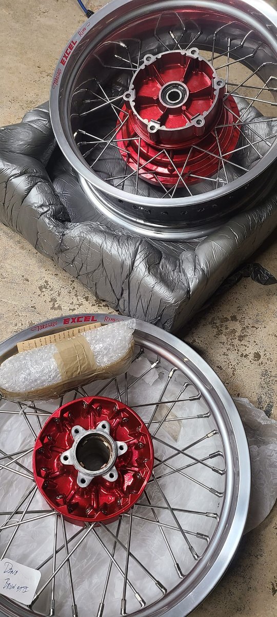

al_roethlisberger Posted April 29, 2023 Posted April 29, 2023 The owner of this 2002 Lemans is located here in NC, and posts in the MGNOC Facebook group, but isn't a member here. He gave me permission to repost the photos of his 2 year project to rework the 2002 into his cafe-style retro vision. Here is a link to the Facebook post:https://www.facebook.com/groups/mgnoc/permalink/10162477829008709/ I've asked him a few questions about the major components you'll see such as the wire wheels, metal (aluminum?) tank, and fairing. So far he's been able to share the following about the wheels... he had them built, in this case from a 1999 California's rims ensuring they were wheels with the dual disc brakes, removed the hubs and had the hubs powder coated, had a custom rear axle spacer made, and then Buchanan's Spoke & Rim (https://www.buchananspokes.com/) laced the hubs to Excel rims for about $800USD. Below is the "before" photo, then the bike with its new wire wheels 1
