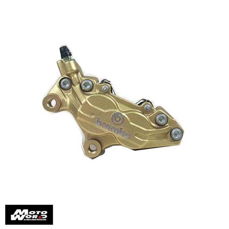

docc Posted May 5, 2023 Author Posted May 5, 2023 57 minutes ago, 80CX100 said: Hey Docc, All of the ones I've got are dark blue, I'm sure they're on the gentle side, but they don't show up on the usual sites,so I can't verify exactly what they are. I'll take a look at what they say about that part # on the OPP site. Thanks! Here is the detail from my OPP invoice: Brembo OE Brake Pad Set, Ferit I-D 450FF Pad Kit for 20.6800.xx / 20.9230.xx Caliper, Shape M - 107670810 [edit]: our early 2-pin calipers (didn't the V11 change to single pin calipers later?) look like these P4 34/30 20.6800: [Yet, I can't tell the difference from this 20.9230:
80CX100 Posted May 5, 2023 Posted May 5, 2023 I don't know about the later bikes;but my 2003 Lemans,possibly my 2007 Griso?, & the black calipers on my 2008 CalVin all look like a match with that photo. fwiw 1
docc Posted May 5, 2023 Author Posted May 5, 2023 I don't know where I got the idea that the front calipers changed to a single pin during the V11 series. A 2003 LeMans is definitely a "later" V11. [edit]: Every image of a V11 I can find, through the 2004 Corsas and the 2004 Scura R, have the same 2-pin front calipers.

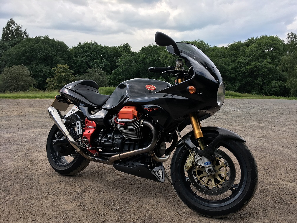

80CX100 Posted May 5, 2023 Posted May 5, 2023 Man that's a beautiful bike with the full Lemans fairing & Ohlins
docc Posted May 5, 2023 Author Posted May 5, 2023 7 hours ago, 80CX100 said: Man that's a beautiful bike with the full Lemans fairing & Ohlins Nero Corsa from @Steve S
