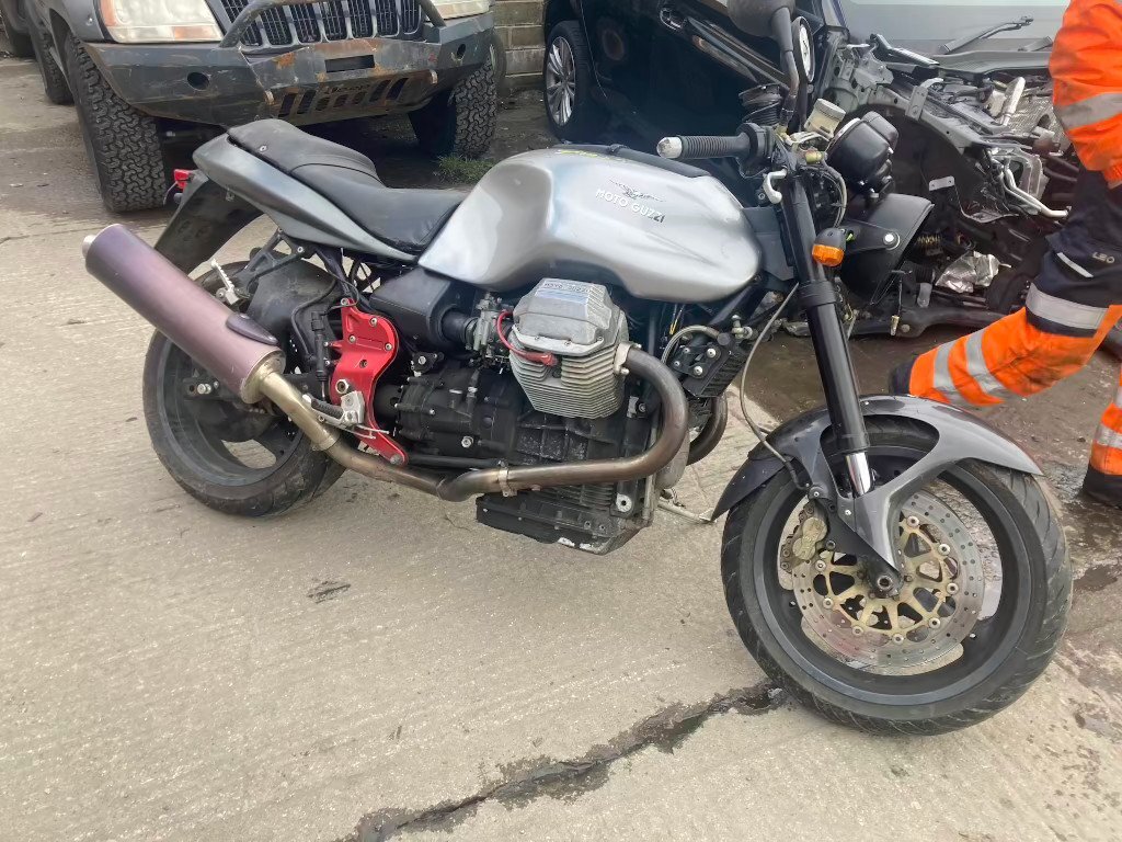

Revilo Posted May 19, 2023 Posted May 19, 2023 IMG_9112.HEICIMG_9112.HEICFetching info... Hi Folks. I had my 2003 Cafe Sport returned to me today looking somewhat the worse for wear nerving been stolen, and later recovered about 2 months ago. I was offered a sum from the insurance company but chose the buy it back option. Now I have it and see it in the cold light of day I can't help wondering if I've done the right thing. Everything is a bit knocked about, but the real damage seems to be fairly superficial. It's going to need some TLC, and I'm going to need a new head lamp, mirrors, indicators, fuel filler cap, ignition barrel and keys, clip-on bars, levers, L/H switch gear, Seat cover and cowl (bum stop), rear brake pedal, and somehow fix the side stand which has lost the weak lower mounting bolt and the bracket is quite bent out of alignment. If all that is all there is I think I'll have got away lightly! I'd like to keep things fairly original but I'm going to have to keep the costs down. I'd be interested in any spare parts people may have gathering dust, or suggestions(especially about the head lamp and the side stand). I think some parts may be common to some Ducati's of the same vintage. Any thoughts very welcome. Happier days ahead I hope. 1 3
audiomick Posted May 19, 2023 Posted May 19, 2023 Here is the picture that Revilo put in his post. His link is to a GIMP image. Not everyone has GIMP, so I exported it as a JPEG. @Revilo bear with it. Best of luck with the restoration. 1 2

80CX100 Posted May 22, 2023 Posted May 22, 2023 Hey Revilo; That's sad to hear about your bike;from 10 ft away it still looks pretty good,but that's a daunting shopping list you have. I've read a few times that the spine frames don't crash well. You have no way of knowing what type of Evil Knievel stunts the thieves attempted while they had your bike for their joy ride. For peace of mind and confidence,before you get too deep into it it would be nice to set it on a stand/jack of some sort so you could verify it's till plumb & square & take a real hard look for damage in known stressor areas,ie tranny bolt/brace,SS bracket bolt to engine,steering head,shock mount,torque arm etc. When you mentioned needing a fuel filler cap,check to make sure it was wasn't pried off so roughly that a simple new cap won;t fit/work properly;same thing if your seat was pried off. Finding parts on your own continent would simplify things. I think there are a few known guzzi breakers/used parts dealers in Europe,a quick search on your local EBAY might show someone breaking a bike for parts. . TLM would be worth a call,a search on their site for used V11 parts,shows they have lots,might be cheaper,idk.https://tlm.nl/search-results-page?q=v11&page=1&rb_product_condition=Used Good luck
Revilo Posted May 24, 2023 Author Posted May 24, 2023 Thanks 80cx100. Some sound advice there. I am trawling through eBay, and have been contacting Gutsibits in the UK who have a few of the bits and pieces I need. I have used tlm before, but hadn't thought about them for used parts. Will update when I make progress. It has to be on the back burner for a few weeks. Busy with too many other projects. Cheers 1
