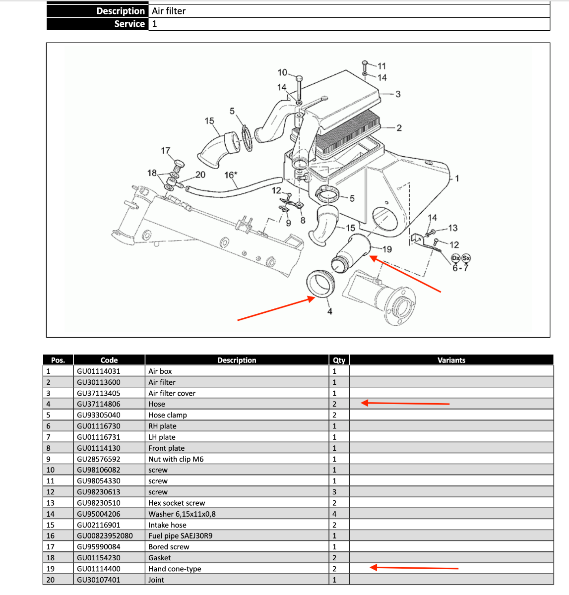

mikev Posted November 30, 2023 Author Posted November 30, 2023 My winter project is hopefully to complete a reinstall of the airbox on my V11. Having some trouble finding parts that go from throttle body to air box, specifically #19 in attached image. #4 are still for sale on mgcycle. Anyone have a source for decent used parts possibly? If not I may have to "modify" whats there somehow to make a tight connection to the airbox.
MartyNZ Posted November 30, 2023 Posted November 30, 2023 On 12/1/2023 at 9:44 AM, mikev said: My winter project is hopefully to complete a reinstall of the airbox on my V11. Having some trouble finding parts that go from throttle body to air box, specifically #19 in attached image. #4 are still for sale on mgcycle. Anyone have a source for decent used parts possibly? If not I may have to "modify" whats there somehow to make a tight connection to the airbox. Item 19 is important. The shape improves airflow into the throttle body. It's called "velocity stack", "bellmouth", or "trumpet", and you should try hard to get the right parts. Have you checked to see if they are wedged into whatever gravel strainer pod filters you had before? 1

Lucky Phil Posted November 30, 2023 Posted November 30, 2023 9 minutes ago, pete roper said: Does it look like it has been cut/chopped/modified in any way? If not I'd think it's probably the original part. I can't remember exactly how they seal to the box. Usually it's some sort of lipped flange but if push comes to shove you could simply install the box and then seal around them with silastic. Not ideal but a zillion times better than pods. Yea they just have a full circle grommet style seal on the airbox Pete and the trumpet inserts from the airbox and connects to the T/B. The rubber seals are still available I think but the trumpets are hard to find, new anyway. Phil 1
Lucky Phil Posted November 30, 2023 Posted November 30, 2023 10 minutes ago, mikev said: doesn't look modified unless they did a really neat job of it No it's modified. Had the bell cut off it to fit the pod filter at some point. https://www.officine08.com/p69547_intake-joint-moto-guzzi-1100-sport-i-e-air-filter.html Airbox seal https://www.stein-dinse.com/en/moto-guzzi-rubber-air-filter-short-1100-sport-i-e-corsa/item-1-1127372.html Phil 1 2
