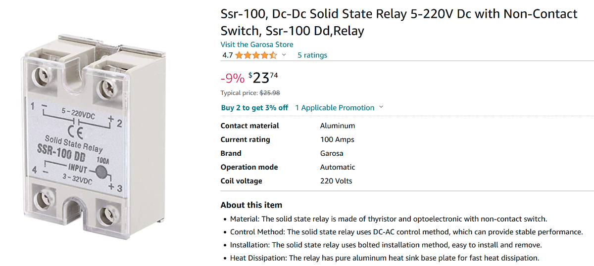

Art Posted June 5, 2023 Author Share Posted June 5, 2023 What do you guys think of these? Hard-wire them in somewhere and forget about them. These are so overkill that heat should not be a problem. Link to comment Share on other sites More sharing options...
