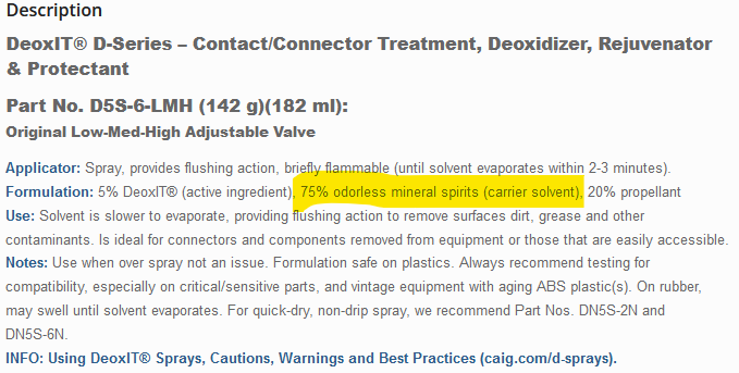

There are those of us who are such fans of what Caig DeOxit® does for connectivity across fuses, relays, switches, and connectors.
Yet, as @PJPR01 recently pointed out, connector seals can swell and tear from DeOxit exposure. Specifically, the green Metri-Pack seal on the V11 TPS and the Casper's TPS Breakout Harness.
But also the yellow TE AMP SuperSeal connectors in the rest of our wiring harness(es). See how this 5-position AMP connector seal swelled after exposure to DeOxit? O
