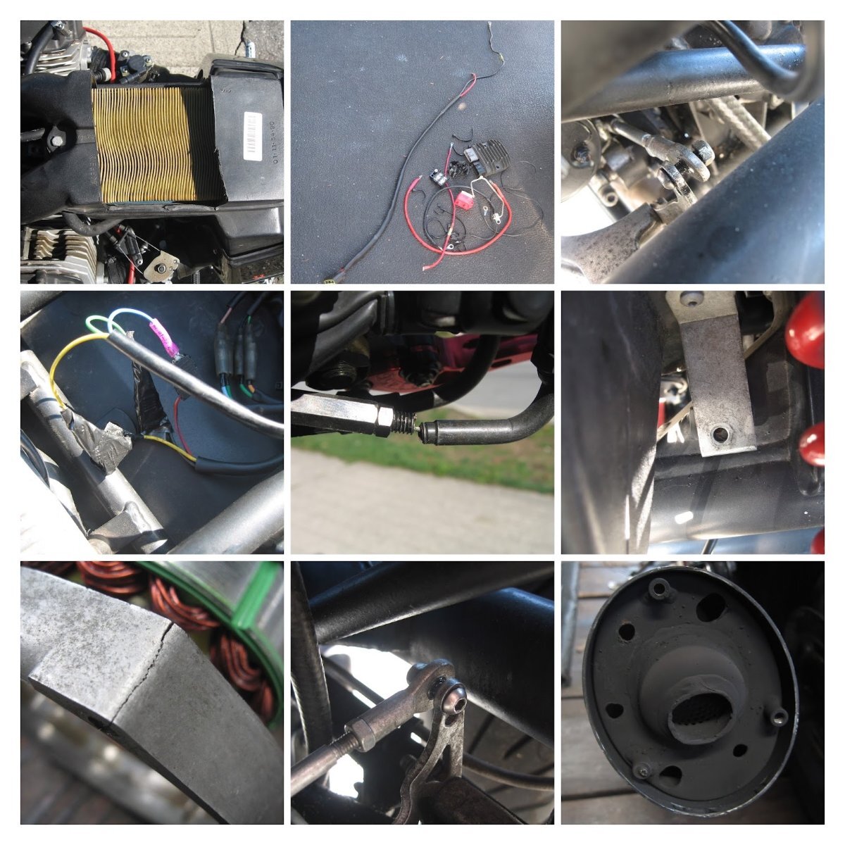

Lucky Phil Posted May 16, 2024 Posted May 16, 2024 @Guzzi-in-Vancouver, The original answer on this was never given. Was the poor running because the L/H throttle body had popped off? I know other things were done but what was the primary issue? Phil 3 1
Guzzi-in-Vancouver Posted June 1, 2024 Author Posted June 1, 2024 @Lucky Phil thank you for asking, I hadn't realized it had been left unsaid, and sorry for the late reply. Yes, the left-hand side throttle body (or is it boot?) had come off, and that was the primary issue. In trying to re-seat it I ended up messing up the screws with the yellow paint, and then the throttle bodies also had to be re-synced. Then all sorts of other issues came to light. For fun, I made a little collage if anyone wants to have a go at diagnosing what was discovered! V11 collage issues.jpg

Rox Lemans Posted June 2, 2024 Posted June 2, 2024 Looking like you need to give her a good lookover and some maintenance. 20 year old bike... But by the look of that air filter, she's had a neglected life. I doubt it'll take much to get her up to snuff. 1
Lucky Phil Posted June 2, 2024 Posted June 2, 2024 1 hour ago, Guzzi-in-Vancouver said: @Lucky Phil thank you for asking, I hadn't realized it had been left unsaid, and sorry for the late reply. Yes, the left-hand side throttle body (or is it boot?) had come off, and that was the primary issue. In trying to re-seat it I ended up messing up the screws with the yellow paint, and then the throttle bodies also had to be re-synced. Then all sorts of other issues came to light. For fun, I made a little collage if anyone wants to have a go at diagnosing what was discovered! V11 collage issues.jpgUnavailable Ok thanks for letting us know. Looks like a few things to replace to bring it up to scratch. What part of the casing is cracked? Phil
Guzzi-in-Vancouver Posted June 2, 2024 Author Posted June 2, 2024 5 hours ago, Lucky Phil said: Ok thanks for letting us know. Looks like a few things to replace to bring it up to scratch. What part of the casing is cracked? Phil I believe the cracked piece is the stator ring. 1
