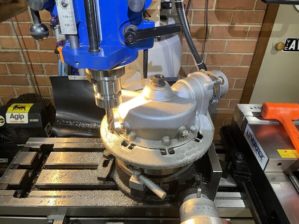

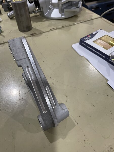

Lucky Phil Posted July 18, 2023 Author Posted July 18, 2023 1 hour ago, docc said: So, @Lucky Phil, aside from the lighter axle, the wheel change you had planned must be a pretty dramatic un sprung weight difference . . . The new wheel is a 5.5 X 17 and fitted with a 180 tyre is around 6kg lighter lighter than the old 5.5 x 17 with a 170 tyre. That's with the hub drives and disks fitted. Then there is the axle and the brake bracket machining which was done for looks not weight saving. Then whatever is saved by machining off the bevel box flange maybe 150gms. 6kg is a decent weight saving swinging on the rear axle. I forgot to measure the weight saving on the front wheel and tyre assembly. Phil 4

Admin Jaap Posted July 19, 2023 Posted July 19, 2023 9 hours ago, Lucky Phil said: I had this done during my G&B Sport Monza build. Together with the light OZ wheel, it made quite a difference. 4
