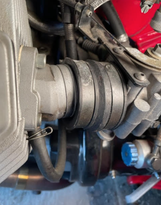

mikev Posted September 1, 2023 Author Posted September 1, 2023 Went over to the bike to see if i could locate the right side idle set screw and noticed this. seems like the left side is not firmly connected to the engine and air is getting sucking in through there. like it got pushed back or something.
