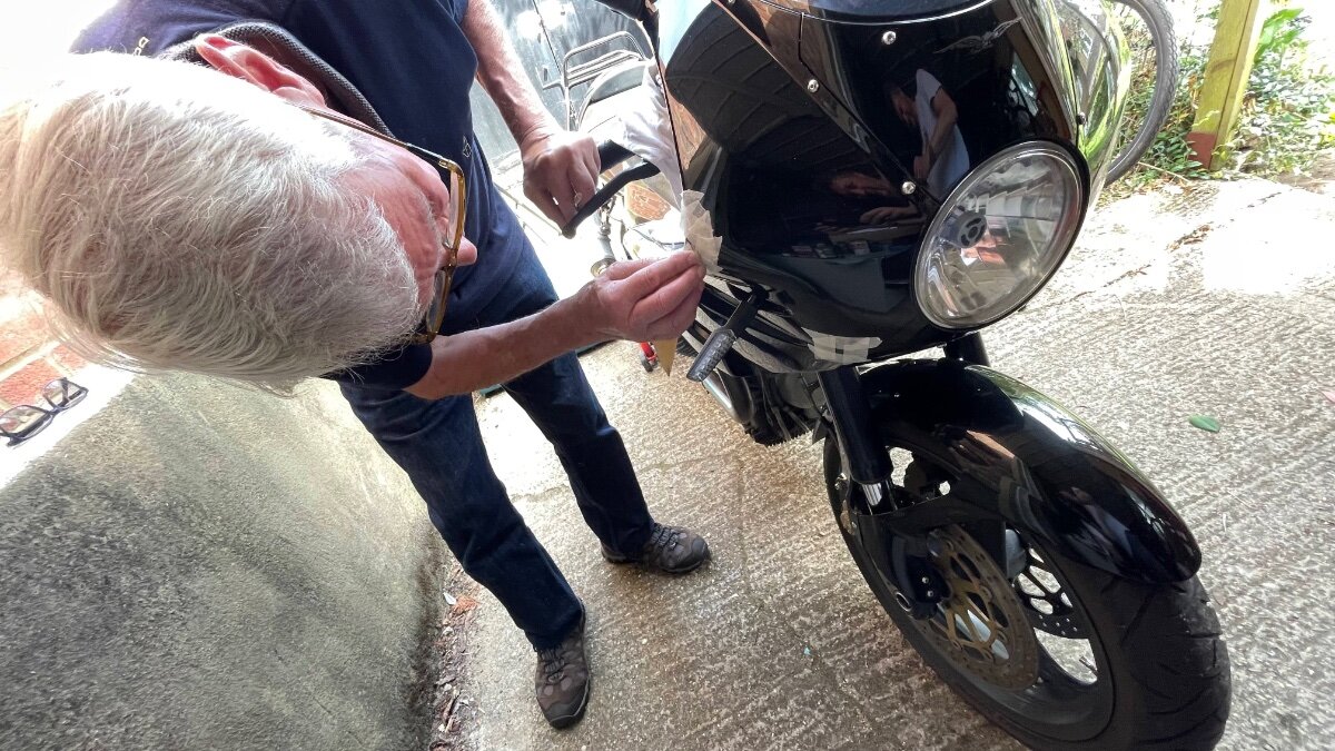

I had a slow speed off and my father in law (ex bodyshop owner) is visiting and helping me fill and paint but we can't find a paint code for gloss black fairing 2003 V11 LeMans anywhere.  Hoping someone on here can help with a paint code or a link.
Thank you
Bob

Hi Lucky Phil
Thanks for the reply.  Mixing by eye would be possible if I could get the bike to the paint shop but can’t  due to ankle injury (I used my ankle to protect the rear paintwork from tarmac last weekend 😀).  Our local paint shop can supply paint by code though and my father in law is only visiting until Tuesday.  It’s a great opportunity to learn how to do it myself from a pro with 60+ years experience!
