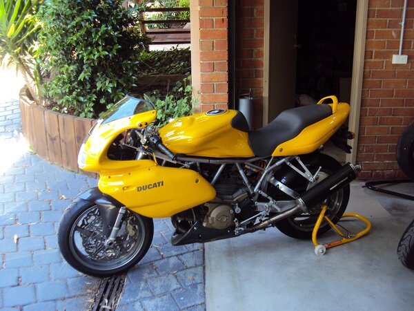

Lucky Phil Posted September 27, 2023 Posted September 27, 2023 You can use "Braking" disks or Galfer disks. I have used both. The part is as common a fit as mud. The Braking disks are mono directional so separate part numbers and the Galfer are Uni directional so same number. Same disk as my 2003 Ducati 1000SS and many other bikes. I can get the numbers if anyone needs them. I have the Braking disks on my 1000SS and the Galfers on the V11. Shopping around I think you can buy a pair new for around 550-600usd. Phil 3

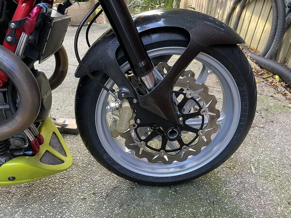

Lucky Phil Posted September 28, 2023 Posted September 28, 2023 29 minutes ago, O2 V11 said: BramF, Have a look at these ones https://www.omniaracing.net/en/brembo-serie-oro-front-floating-brake-disc-for-moto-guzzi-v11-mans-20012005-p-164545.html Rob Just make sure you email them before you order. I bought and paid for a new Brembo calliper from them a few weeks ago and they informed me they aren't available anymore which I already knew. So they don't stock stuff. They refunded my payment promptly but I lost out on the exchange rate and charges and they had my funds for 5 or 6 days. I mentioned this scenario in a recent post. None of these sellers carry stock and they don't keep track of the availability from their suppliers. Personally I'd go for wave disks myself. Phil 1
