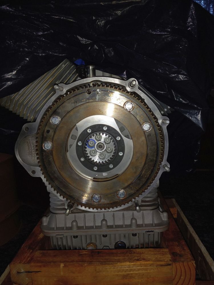

Cold Desert Rat Posted August 31, 2023 Posted August 31, 2023 2002 Scura 11k miles replaced original aluminum single plate clutch with new RAM clutch assy from MG Cycle (good folks) waited forever for new 6spd clutch hub also from MG Cycle. see it in the picture next to the original they are dimensionally identical except for the 6mm longer external splines on the new guy. it appears to be too long to even allow the trans to mate with the bell housing. i suppose i have to machine off 6mm, which i am annoyed but okay with i searched but didn't find this precisely but my seasrch-fu is weak anyone come across this? thank you

footgoose Posted September 1, 2023 Posted September 1, 2023 The clutch hub you need is GU01211640. This is the hub that came with the RAM kit for 6 spds, which was discontinued because they ran out of oem hubs and couldn't source them (we think). That hub was already used in oem Scura/Tenni assemblies, so use the one from your Scura. I think (but not sure) the one MG sold you was for a 5 spd. What I am unsure of in your case is the actuating rod length and it's compatibility with the spring actuating cup. Pretty sure the Scura rod and cup will work. I purchased one of the last RAM 6 spd kits and the GU01211640 hub came with it. 2

footgoose Posted September 1, 2023 Posted September 1, 2023 If this is the hub you got from MG it IS for a 6 speed but for use or conversion to a dual plate assembly. https://www.mgcycle.com/index.php?main_page=product_info&cPath=193&products_id=5222 The RAM assembly that is sold for a 5 speed is intended to convert the std dual plate assembly to the lighter single. So it would include the hub and cup to accommodate the 5 speed actuating rod, which differs in diameter and (maybe) length to the one in your Scura. Confused? Me too

footgoose Posted September 1, 2023 Posted September 1, 2023 I got one of the last 3 that MGCycles offered. Scud, myself, and (forgot who* else) got on a wait list and eventually received them. The GU01211640 hub came with the kit, as seen in the photo. It is the same as the oem in the Tenni. I re-used the original. * might have been @craigsinclair that got the other one? I recall a member doing the 5 speed RAM kit successfully and posting about it. ?? 1

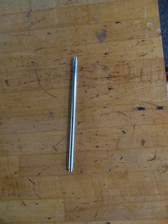

Cold Desert Rat Posted September 4, 2023 Author Posted September 4, 2023 It seems all is well. Did careful measurement using depth mics and using the trans/engine case split as the datum. There's 3mm+ before the splines can touch the pressure plate. So, that seems good. The hole in the pushrod button on the new RAM pressure plate is 6mm. I modified my 8mm pushrod to fit which makes it reversible. I didn't dry fit the trans because I'm pretty sure it's fine. I'm waiting on the o-ring that goes on the splined shaft under the clutch hub from Harpers. Curtis is also sending the clutch slave. Then I can confirm pushrod length. So far all is good. I got a little excited. Thanks to everyone for all the help! 3
