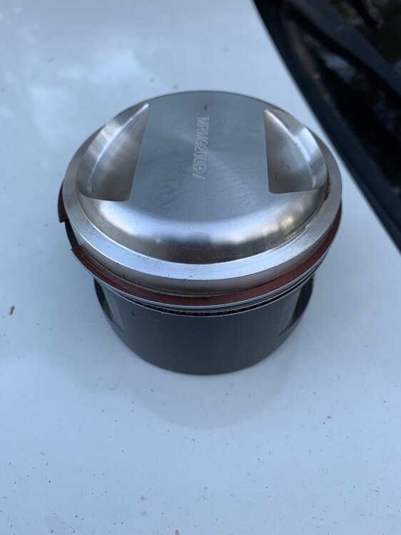

Eamonn Posted December 22, 2023 Author Posted December 22, 2023 Hi Kevin_T, When I weighed the piston the gudgeon pin was in place, the piston & rings minus the pin is 488gms & the gudgeon pin weighs 91gms (metric), I don’t know what the Oem piston weighs but I was under the impression that they were exactly the same as the MR piston. The difference between yours & the MR piston is quite surprising. Could it be down to US grams & metric grams..?

Kevin_T Posted December 23, 2023 Posted December 23, 2023 Thanks for the picture. I'm surprise at how sharp the valve cutouts are. I'd imagine setting up squish would be very important. The dome is very flat, flatter then the Oem piston got to help with flame spread. Hemi heads are legendary for being able to fill a cylinder. They're also legendary for not being able to burn everything they take in. My Oem piston is lighter @ 457.2 grams the wrist pin was heavier @ 106.9. If you install those pistons do yourself a favor and put some money in the budget for a balance job. 1
