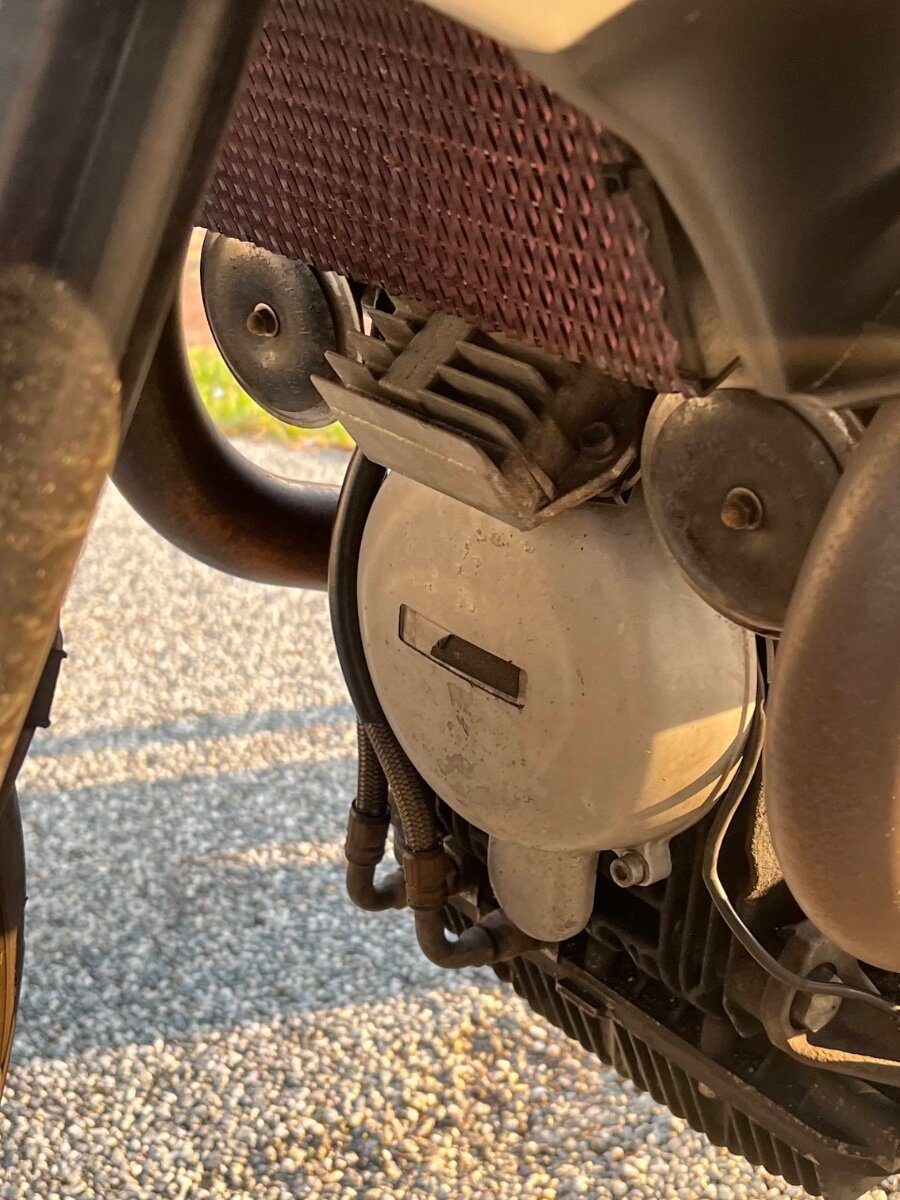

innesa Posted February 1, 2024 Posted February 1, 2024 (edited) IMG_8350.HEICHello V11 Brains Trust I have a 2001 V11 LM, that appears to be haemorrhaging oil from the oil cooler. I am wondering if there is any issue with simply disconnecting the hoses at the sump, replacing them with sump plugs/ similar, & binning the oil cooler altogether? A mate has a Griso, & he decommissioned that bike's oil cooler, however, replaced the hoses with a single much shorter hose, between the two sump ingress/ egress points due to "one-way flow". Is there a similar issue with the LM? Thank you Edited February 1, 2024 by innesa photo

guzzler Posted February 2, 2024 Posted February 2, 2024 On 2/1/2024 at 5:06 PM, innesa said: IMG_8350.HEICHello V11 Brains Trust I have a 2001 V11 LM, that appears to be haemorrhaging oil from the oil cooler. I am wondering if there is any issue with simply disconnecting the hoses at the sump, replacing them with sump plugs/ similar, & binning the oil cooler altogether? A mate has a Griso, & he decommissioned that bike's oil cooler, however, replaced the hoses with a single much shorter hose, between the two sump ingress/ egress points due to "one-way flow". Is there a similar issue with the LM? Thank you G'day mate Is it from the oil cooler? I just had the infamous breather hose replaced on my V11 Sport which did the same thing and it's whereabouts and where it bursts would lead you to think it was something disastrous... Just asking... Cheers Guzzler 4
docc Posted February 2, 2024 Posted February 2, 2024 2 hours ago, guzzler said: G'day mate Is it from the oil cooler? I just had the infamous breather hose replaced on my V11 Sport which did the same thing and it's whereabouts and where it bursts would lead you to think it was something disastrous... Just asking... Cheers Guzzler That is really good advice, @innesa. Unfortunately, the image in the original post is not visible in that format. Oil leak at the upper front of the V11 motor is so much more likely from the ratty breather hose than the oil cooler, itself . . . 2

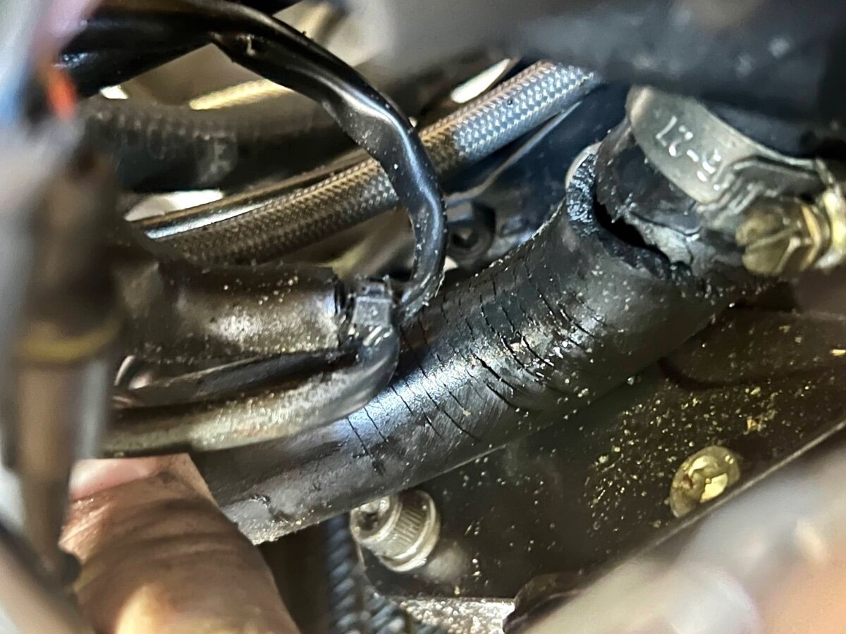

innesa Posted February 3, 2024 Author Posted February 3, 2024 Thank you for all of the replies, comrades Aussie Guzzisti will likely know who I'm talking about when I say I placed a call to Mario @ Thunderbikes yesterday, re parts, &, I guess in some ways reassuring, also asked if I was sure it was the cooler, as he'd never heard of anybody having an issue with one before. So I will delve further, & find out if the breather hose is indeed the culprit. You are right though - it looks like somebody has slit the throat of something that has oil for blood! Excellent timing too, as I was going to look at it either today or tomorrow. Thanks again, everybody 2

innesa Posted February 14, 2024 Author Posted February 14, 2024 Hello my friends. I’d just like to update y’all on my progress: Thank you for all of the information, & for putting me on to the oil breather hose issue. I referred to the technical issue also found on this forum, & essentially replicated somebody’s idea about the rubber hose, copper angles, & hose clamps. Sprayed some engine degreaser to remove the leaked oil, & went for a bit of a spin. There is no oil leak from the cooler, & I don’t know if it’s in my head, but the bike seems to be running better than it ever has since I’ve owned it. Now for the decent tune! 5
gstallons Posted February 14, 2024 Posted February 14, 2024 You may as well buy two of these hoses , one to install and one to keep around for a spare . When you install this be sure to index the hose clamps so when you do it AGAIN and AGAIN you will have less trouble with R & R . BTW , if you go with the homemade design , keep in mind this will have to be compatible with petroleum . You may spend more time with your innovation than buying an OEM part. Don't feel like the Lone Ranger , we all have a breather tube that did/does look like this . 6
