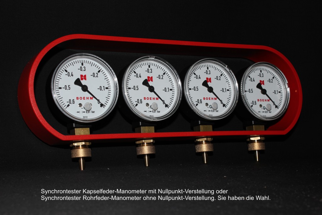

audiomick Posted February 9, 2024 Posted February 9, 2024 Just for the sake of showing off, I've got a set of these: https://www.boehm-synchrontester.de/ I don't expect that they are available in the USA, but who knows. They're fiddly, because one has to adjust the damping on them for the best compromise between "open enough to measure realistically" and "closed enough to stop them oscillating madly". Despite that, I really like using them. Probably because it's fiddly, and you feel like you're being really professional. And they're just pretty. 2 3
