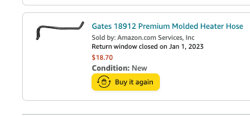

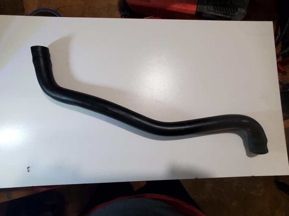

gstallons Posted February 14, 2024 Posted February 14, 2024 On 2/13/2024 at 9:02 PM, LaGrasta said: Many OEM hoses I found listed, weren't actually available. I agree though, if I could have purchased the OEM one, I would have. At the time, I think the only place that had it was in Germany and it was like $80 plus shipping. Interesting enough, I only paid $18, and free shipping. I see now, it cost twice that amount! Expand That hose is for coolant and it MIGHT not be compatible with petroleum . This may not last as long as you would want.

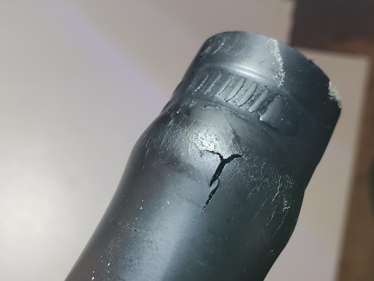

FreyZI Posted March 6, 2024 Author Posted March 6, 2024 Started into this project today. Looks like the recent blowout only added to years of oily gunk in there. One benefit to having the frame caked in an oily mess is no rust. Tank off, fairing off, air box off, breather hose off. Here's what it looks like: Other end has similar, if slightly smaller cracks. I was expecting bigger. What kind of pressure does this hose carry? One thing of interest (to me), the hose was installed upside down (i.e., as shown in the photo). As a result, the hose was pressed against the farthest aft fin of the voltage regulator. I suspected there might be a hole at that spot, but looks like just a bit of an indentation there. Tomorrow begins deep cleaning. 2 1
audiomick Posted March 6, 2024 Posted March 6, 2024 On 3/6/2024 at 3:50 AM, FreyZI said: What kind of pressure does this hose carry? Expand Not much. There is a hose that attaches to the top of the frame just behind the steering head and vents into the airbox, so the whole breather system is open to the outside in the end. There are surges in there no doubt, but I can't imagine that the absolute pressure in the system is at any time all that far away from ambient atmospheric pressure. 2
