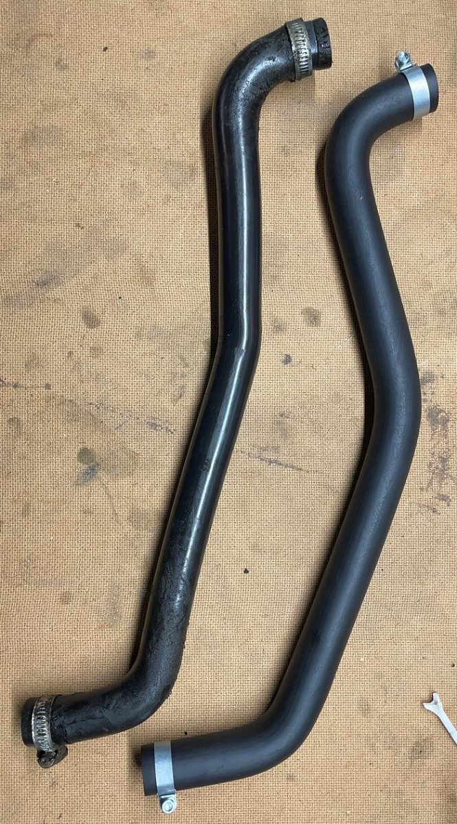

cowtownchemist Posted March 12, 2024 Posted March 12, 2024 I replaced my breather hose over the weekend. Getting the old one out was pretty easy with the tank off. Getting the new one in was a struggle. There is just not much room to get your hands in there and get the right leverage to force the hose onto the openings. But after a few choice words and a little determination I got it on securely. One thing I learned is that the MG Cycle breather hose clamp is too small for the upper attachment to the frame. It worked for the lower side to the engine but I had to use the original clamp for the upper end. https://www.mgcycle.com/index.php?main_page=product_info&cPath=71&products_id=1186 https://www.mgcycle.com/index.php?main_page=product_info&cPath=71&products_id=2785 Old vs. New 3 3

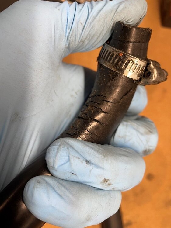

audiomick Posted March 12, 2024 Posted March 12, 2024 3 hours ago, guzzler said: Exactly where mine went too! I dare say they all give up more or less there. The motor is "rigidly" mounted to the frame, so the motor movement (vibration) relative to the frame is probaly fairly minimal. The hose, however, has two long straight sections with a bend in the middle, and no support along the way. The vibrations caused by the motor have a significant sideways component, so the hose is going to be moving like the belly on a fat cat when it gets a trot up on the way to dinner. The hose no doubt vibrates along its length quite a lot, and that no doubt puts stress on the bends at the ends and the anchor points. Incidently, there are a lot of really good excuses for having a paunch in there... 2

docc Posted March 13, 2024 Posted March 13, 2024 Also, be aware this vent hose can be abraded by contact with motor parts . . . 1 1
