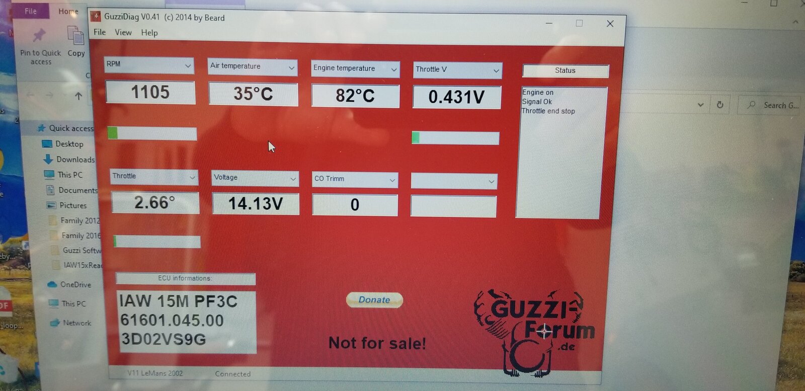

Speedfrog Posted February 28, 2024 Posted February 28, 2024 On 2/28/2024 at 7:23 PM, 80CX100 said: I understood that some of the later '04 models had a 15RC,idk Expand For clarity in the matter of ECU type, none of the V11 Sports US models came with 15RC nor O2 sensor. Only Euro models! If your V11 Sport is a US import, it came with a 15M and no Lambda sensor - so unless it was modified by a PO . . . . 2
ScuRoo Posted March 10, 2024 Posted March 10, 2024 On 2/28/2024 at 8:57 PM, Speedfrog said: For clarity in the matter of ECU type, none of the V11 Sports US models came with 15RC nor O2 sensor. Only Euro models! If your V11 Sport is a US import, it came with a 15M and no Lambda sensor - so unless it was modified by a PO . . . . Expand Correct. 👍😎 No US V11 models. Only the later V11 models destined for European countries, including Britain, Australia. New Zealand. The US models missed out on the 15RC ecu which has the O2 sensor closed loop feedback. I’d pointed this out previously. This is an international forum where folks with v11’s outside the US come seeking information. 1
Lucky Phil Posted March 11, 2024 Posted March 11, 2024 What about later bikes post 2002 to the US like the Le Mans and all the other naked variants from 2002-2006? All 15M in the USA? Phil
docc Posted March 11, 2024 Posted March 11, 2024 On 3/11/2024 at 1:12 AM, Lucky Phil said: What about later bikes post 2002 to the US like the Le Mans and all the other naked variants from 2002-2006? All 15M in the USA? Phil Expand Pretty sure, yes: "All 15M in the USA." Not sure I have ever heard of a "2006" V11. Or even a 2005 in the USA. I was thinking the 2005 Scura R was the last of the breed, but have never heard of one of those in the USA . . . 1
Lucky Phil Posted March 11, 2024 Posted March 11, 2024 On 3/11/2024 at 1:20 AM, docc said: Pretty sure, yes: "All 15M in the USA." Not sure I have ever heard of a "2006" V11. Or even a 2005 in the USA. I was thinking the 2005 Scura R was the last of the breed, but have never heard of one of those in the USA . . . Expand Ha, just checked MCS and the last V11 year model listed is the 2003 Ballabio. Here's me thinking they made them until 2006. I told you I find the year model thing confusing. Phil
Tinus89 Posted March 14, 2024 Posted March 14, 2024 My V11 pinged in the 4000-5500rpm range during warmer weather and WOT. She is equipped with pod filters (PO did that, I like the sound so I keep them). I solved the problem by (in steps) increasing the fueling using Guzzidiag and Tune ECU ( I thought that was the software, but could have been the Aprilia Caponord as well) in that area slightly.
ScuRoo Posted March 15, 2024 Posted March 15, 2024 On 3/11/2024 at 1:20 AM, docc said: Pretty sure, yes: "All 15M in the USA." Not sure I have ever heard of a "2006" V11. Or even a 2005 in the USA. I was thinking the 2005 Scura R was the last of the breed, but have never heard of one of those in the USA . . . Expand The Scura R was indeed the last iteration of the breed. A handful each to selected European countries only. UK received 4 in total. Articles indicated there were only supposed to be 23 made. A reputable Guzzi source refuted that & stated 18 in number only. 1
p6x Posted March 15, 2024 Author Posted March 15, 2024 The truth is, my V11 works better now, engine knocks or not. Acceleration has improved, the 3k engine misses are gone (so far), and my fuel mileage is now matching the forum's consensus. My highway mpg is now around 38, when it was always above 40 before the new map. I just ride around the knocks and that takes care of it.
