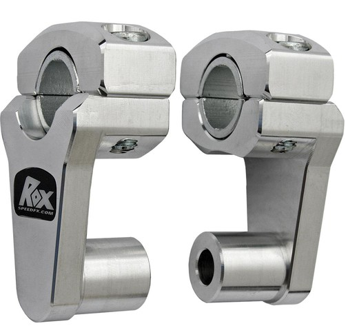

FreyZI Posted February 21, 2024 Posted February 21, 2024 I'm attaching pics of the risers on both my V11s. In the bottom pic, you'll see that risers had been switched left to right, with the towers closer to rider. It would be possible to simply switch the risers from one side to the other, with the bars no higher, but substantially closer, obviating the need for any purchase. It would also be a really quick fix, because you'd not have to change anything on the clip-ons, just quickly swap risers. Just be careful you have plenty of clearance between clip-ons and fuel tank. Not attractive, but on my F800GS I installed a set of Rox Risers, which have served me well. On the Tenni: On Bubbles: 2
