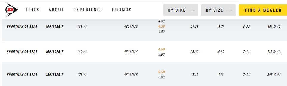

GuzziMoto Posted March 7, 2024 Posted March 7, 2024 8 hours ago, guzzler said: G'day folks. I was flicking through Total Control by Lee Parks recently and came across a section on Traction. There was mention of a bloke on an SV650 who was achieving pretty good lean angles on his standard tyre which on the SV was a 160/60 jobbie on a 4.5 inch rim like our red frames .It then went on to mention that a 160/60 wasn't really designed for a 4.5 inch rim but for a 5 inch rim.In fact by fitting this tyre to a 4.5 inch rim it's pinching it to the point that you can't use the very edges of the tyre unless you crash! I've been running the 160/60 profile on mine for years now and have often wondered why I can't seem to get to the very edges of the tyre! I don't really think about it when I'm riding ( nor care a great deal ) but I also reckon I achieve decent lean angles and have about 15mm of unused tyre at the very edges so in order to sate my curiosity... How's your chicken strips? Cheers Guzzler Ps I'm pretty happy with the 160/60 profile and have no complaints really...just curious. Not sure where he got his info on wheel widths vs tire, but often the recommended width wheel for a 160/60 tire is 4.5" Here is a shot from Dunlop's web site for their Sportmax Q5 in a 160/60-17. The width in red is the recommended width, the width in black is acceptable. 1
GuzziMoto Posted March 7, 2024 Posted March 7, 2024 The width of the wheel does affect the tires profile, for sure. And a wider wheel will tend to flatten out the profile. But to suggest that a 160/60-17 tire is being pinched mounted on a 4.5" wide wheel seems wrong. Someone may prefer a wider wheel for a 160, but that is not how the tire was likely built. Sadly, specs like that are harder to find then they used to be. I appreciate that Dunlop still publishes info like that right up front. Not all tire manufacturers do nowadays.

audiomick Posted March 7, 2024 Posted March 7, 2024 7 hours ago, Lucky Phil said: My 1198 rear tyre. The bikes not even run in yet Smarty pants. Avon is another one who states "recommended rim width" and such. For instance here (not a recommendation for the tyre, just for the information!!). The 160/60 17 is listed with 4.5" as the recommended rim. (scroll down to the bottom half of the page to see the table...) https://www.avontyres.com/de-de/reifen/3d-supersport?searchtype=tire&cartype=motorcycle 1
