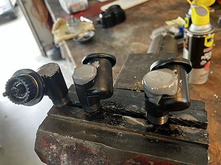

LaGrasta Posted June 10, 2024 Posted June 10, 2024 Once I took a few items apart, it was apparent what happened. After some JB Weld, all should be fine.
docc Posted June 10, 2024 Posted June 10, 2024 On 6/10/2024 at 3:56 PM, LaGrasta said: Once I took a few items apart, it was apparent what happened. After some JB Weld, all should be fine. Expand So, the metal disc had dislodged causing the gears to mis-mesh?
LaGrasta Posted June 10, 2024 Posted June 10, 2024 The disc was missing from the one on the speedo. I had a damaged angle drive in the parts bin, so I dismantled it and used that disc. Rather than just repairing the speedo angle drive with the JB, I did both of the ones on the bike as well as an NOS extra I had, just in case. My test ride proved successful! 4
