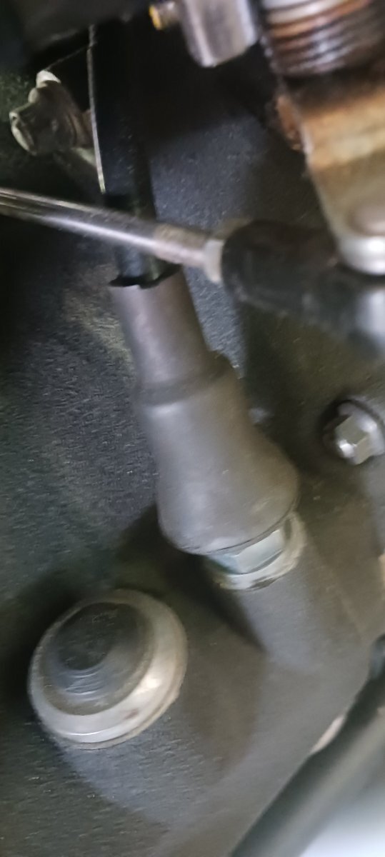

Lucky Phil Posted June 10, 2024 Posted June 10, 2024 On 6/10/2024 at 8:42 PM, LaGrasta said: The disc was missing from the one on the speedo. I had a damaged angle drive in the parts bin, so I dismantled it and used that disc. Rather than just repairing the speedo angle drive with the JB, I did both of the ones on the bike as well as an NOS extra I had, just in case. My test ride proved successful! Expand Some detailed images of the actual issue might have been nice. Images of speedo drives with blobs of JB on them don't tell us much I'm a images person I don't read very well. Phil

LaGrasta Posted June 27, 2024 Posted June 27, 2024 Speedo, speedo, speedo; my on-going adventure. Today maintaining 80mph, I noticed the needle dropping, then holding at 30mph, while still doing 80. I reach behind the gauge, rattle the cable, no change. I then reach down to the trans angle drive and bingo, it's been backed out a bit, on it's own. I screw it back down and all is well. A little lock-tight or similar will be applied tonight when I get home!
docc Posted June 27, 2024 Posted June 27, 2024 I used the crank mine down with slip-joint pliers. It's a hairy-knuckled cludge, but helped. Just a reminder to inspect the screw down housing where it is inserted into the angle drive. Make certain is pressed in fully.
