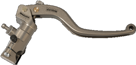

Guest 1100sport Posted June 26, 2004 Posted June 26, 2004 The other one is a very high end radial master cylinder made by Magura. It is available in 20mm cylinder diameter for superbikes... Available for approx 300 euros/dollars.

Paul Minnaert Posted June 26, 2004 Posted June 26, 2004 The magura is the same as the PVM, only the PVM ( made by magura) has 3 positions where the pivot where the brake rotates around can be put in. So you can change the ratio, without buying another handle. The disicati is not sold in many places, and so pretty unknown.
Guest 1100sport Posted June 26, 2004 Posted June 26, 2004 Paul, I now understand why the Magura and PVM look so similar... By the way, if you are interested, there is right now a huge discount on the Magura/PVM unit. The retail price is 390 dollars, but it is now offered at 290 dollars. See at motostrano : http://www.motostrano-store.com/marapu.html I just bought them a pair of Sato Racing clip-on handle bars and they have been nice and efficient. Al, I see no logical reason why your current master cylinder would not work (it should be a 15 or 16 on the latest Le Mans ??) although I have not done it myself so I dont know for sure. It should have enough power to satisfy the radial calipers : as the radial calipers flex less, they require less power for the same braking force than regular calipers. However, the difference made by radial calipers alone should be far less noticeable than puting radial 19mm master cylinder. Mathieu
