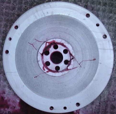

Paradiso Posted April 8, 2024 Posted April 8, 2024 Do you know anyone yourself or have you seen one in personn? a single plate clutch "Blown up"? There was one photo of one several years ago that failed..although I have never read a personal account about it..The phot has been beaten to death over and over for 10 years or more on the internet but I have yet to see one that "blew up" or to meet anyone on any of the forums who had one "blow up" them selves..I've owned 3 2002 V-11's 2-Scura's and a Rosso Mandello. with them..none blew up...So yes..I'd like to see some "Solid" information too.My Tenni, which I still have, had cracks around the bolted centre (of the flywheel) when I replaced it with a dual plate clutch. I posted photos when I did the job. It would have broken apart if I hadn't replaced it. The bike had done about 13 000 miles at this point.Sent from my SM-S901B using Tapatalk 1 2
Paradiso Posted April 8, 2024 Posted April 8, 2024 My current phone is not very good for close up photos, but you can see the cracks.Sent from my SM-S901B using Tapatalk 1 2
Rox Lemans Posted April 8, 2024 Posted April 8, 2024 The "Explodamatic Single Plate" thing shouldn't be a worry until around 25-30k miles. My Scura was an exception at 23k since the guy who had it used it on the track. But it's not that it's a bad flywheel. It's a really good flywheel. But it's a RACING lightweight flywheel and not designed for performance, not longevity. There are guys here with the dual plates with 100k+. But with any of these performance flywheels, it's something to be aware of. Changing that flywheel is no picnic. In fact, it sucks. But the photo above is how it starts. I'm prety sure the flywheel that was pulled out of my Scura started cracking in the same spot. But the bike will give plenty warning. You can hear it and feel it. And apparently, you can't just swap for a dual plate. At least that's what I was told.

Paradiso Posted April 8, 2024 Posted April 8, 2024 The "Explodamatic Single Plate" thing shouldn't be a worry until around 25-30k miles. My Scura was an exception at 23k since the guy who had it used it on the track. But it's not that it's a bad flywheel. It's a really good flywheel. But it's a RACING lightweight flywheel and not designed for performance, not longevity. There are guys here with the dual plates with 100k+. But with any of these performance flywheels, it's something to be aware of. Changing that flywheel is no picnic. In fact, it sucks. But the photo above is how it starts. I'm prety sure the flywheel that was pulled out of my Scura started cracking in the same spot. But the bike will give plenty warning. You can hear it and feel it. And apparently, you can't just swap for a dual plate. At least that's what I was told. I don't think the flywheel failure would be a gradual or predictable thing. How could you tell when the cracks shown in my photo would spread and the flywheel break apart? People are free to make their own guesses, but I would not take the risk. I took mine apart because the clutch was worn. I only noticed the cracks afterwards. The twin plate V11 sport clutch is a direct replacement. The new parts about 8 years ago were over £2500. I managed to find a second hand steel clutch assembly for a lot less, but it took some time.Sent from my SM-S901B using Tapatalk 1
Rox Lemans Posted April 8, 2024 Posted April 8, 2024 37 minutes ago, Paradiso said: I don't think the flywheel failure would be a gradual or predictable thing. How could you tell when the cracks shown in my photo would spread and the flywheel break apart? People are free to make their own guesses, but I would not take the risk. I took mine apart because the clutch was worn. I only noticed the cracks afterwards. The twin plate V11 sport clutch is a direct replacement. The new parts about 8 years ago were over £2500. I managed to find a second hand steel clutch assembly for a lot less, but it took some time. Sent from my SM-S901B using Tapatal It's not that I can tell WHEN. It's just WHEN they tend to crack. That's where mine started. Anyone whose had to change their flywheel had to around 25k miles/40k km. Consider it anecdotal. But it's been consistent. And that grinding sound when you rev the motor in neutral at high rpm? Anecdotal? You catching yours when you changed the clutch without the symptoms may be you got lucky. I've never seen one explode, but I've seen the pics of shards of crankcase.. Not good at all. But as I've said, these performance flywheels were put in for performance, not longevity. Likely, something nice to put in the moto magazines: "Look! A racing flywheel!!" It's why my Scura has become my special occasion bike. Keep it clean and look pretty cruising.

footgoose Posted April 9, 2024 Author Posted April 9, 2024 there are enough to make me swap it out. another unfortunate the pics are gone from this post. I believe this one was the one that blew out the bell housing part of the engine case. If you saw this photo you would be convinced. It may have been reproduced in another thread. Search more, it goes waaay back. Exploding clutch, exploding flywheel, etc another 1
docc Posted April 9, 2024 Posted April 9, 2024 There have long been concerns, and reports, of cracking or failures of the aluminum flywheel mated to the single plate clutch on the 2002 Scura, 2002 Tenni, and (perhaps) the 2001 Rosso Mandello. To clarify: it is not a clutch failure, but cracking of the flywheel around its mounting to the crankshaft potentially progressing to separation and extensive damage. Many have preemptively converted their "single plate clutch"/ aluminum flywheel to the V11 double plate/steel flywheel or installed an aftermarket RAM clutch/flywheel unit. Those solutions are detailed elsewhere and may be linked here. This topic is meant to chronicle reports of actual failures. 2
