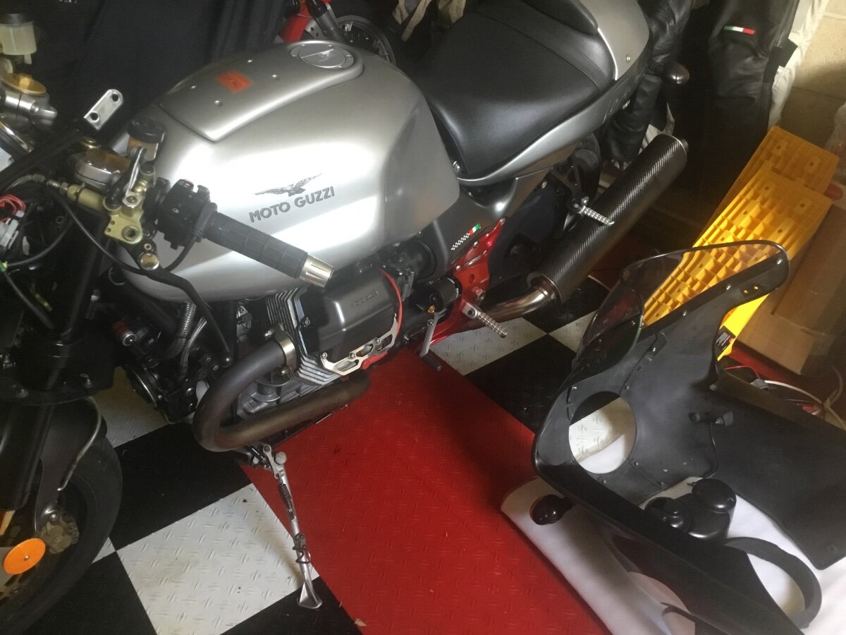

Tennitragic Posted January 10 Posted January 10 Hello fellow enthusiasts….closing in on 70 years so more a collector than a rider these days!…and moved to Guzzi from Laverda’s! Purchased a Tenni recently (photos to follow) Albeit bit of a Tech Luddite, will have to learn forum linking/sending photo’s etc. Currently recommissioning the bike for the roads ‘down under’. Continuing this thread as the Tenni’s previous owner said the flywheel/clutch are originals. Lurking and reading here made me aware of common faults including flywheel. And some owners adapting/fitting the RAM 5 speed clutch assembly because the crucial clutch hub is oem in Tenni/RM/Scura….all thanks to you guys…! Stein Dinse helped to date with Guzzi parts but are now dissuading me from purchasing “Moto Guzzi Single disc clutch RAM - big models No. 200001620”. Checked with MG Cycle about Part Number MG1096620 but they said they are “unaware this 5 speed will work with a 6 speed”. Should I go back to them or am I missing something? Thanks for any help here as I realise this is a very tired old topic! 2

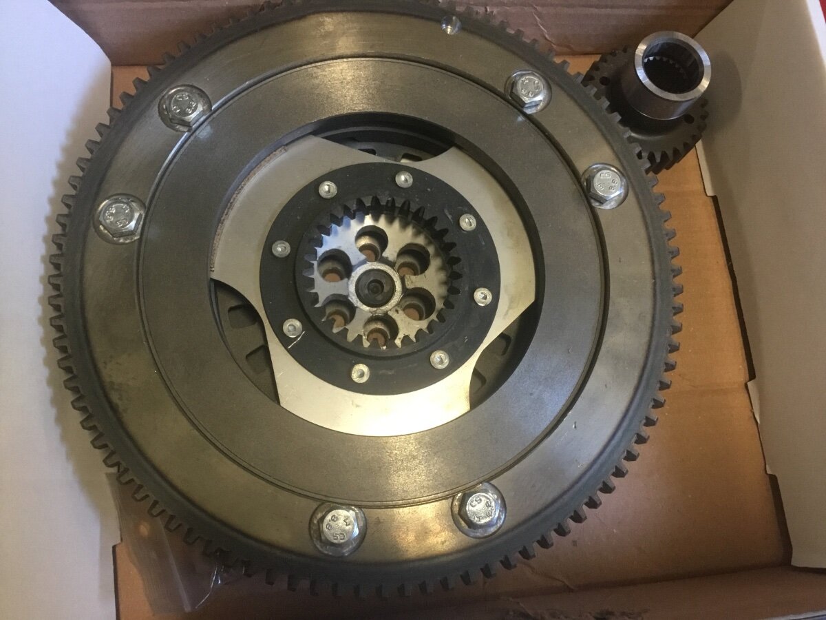

Tennitragic Posted January 11 Posted January 11 Many thanks Lucky Phil for this advice!….Aussie dollar has ‘collapsed’ compared to the U.S.$ lately so why SD prices don’t look too bad! Just to confirm for this V11 series novice, SD #200001620 and MG Cycle #1096620 RAM parts are the same kit? Better images with bike back together will eventually follow….regards, Tennitragic. 2
Lucky Phil Posted January 12 Posted January 12 (edited) Not sure if the SD clutch comes with the same friction disk. Ask SD if it has the MIBA friction disk and if it's the latest steel flywheel version. Make sure they do a physical check on the flywheel material, you know spare parts people. They know part numbers not actual things. Phil Edited January 12 by Lucky Phil
Tennitragic Posted January 13 Posted January 13 Cheers docc! Thanks to all who have been there before….MG Cycle appears to have what is needed…and not Stein Dinse from previous commentary. 1

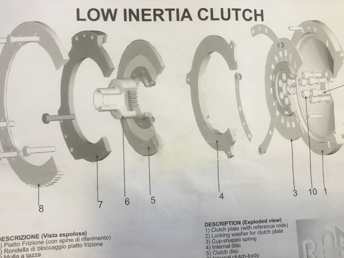

Tennitragic Posted February 4 Posted February 4 A new RAM low inertia clutch has arrived….looks correct for the Tenni when I refer to many other owner posts. But thanks to Lucky Phil, docc,gstallons and others who have been down this road. Now to fit….prefer experienced Guzzi mechanic and not spanner this one myself. Any suggestions ‘down under’?
