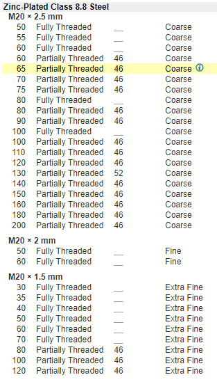

GuzziMoto Posted April 11, 2024 Posted April 11, 2024 I think M20x2.5 is considered coarse thread, and M20x2.0 is considered fine thread. M20x1.5 is considered extra fine thread. I don't know if there is a M20x1.0 thread. 1
GuzziMoto Posted April 11, 2024 Posted April 11, 2024 Also figure I would add that in metric bolts the thread value is the distance between each thread. So, the larger the bolt the higher the value all else being equal. And the smaller the bolt the lower the value. A larger diameter bolt will have a larger gap between threads when the thread is at the same pitch / angle.

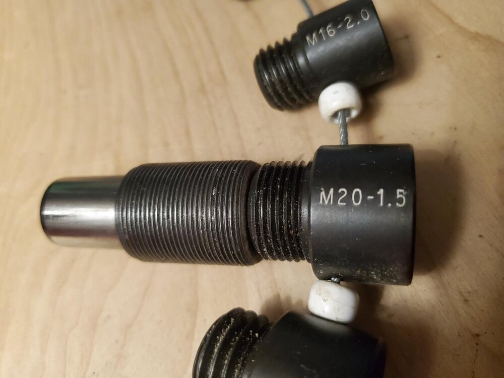

FreyZI Posted April 11, 2024 Posted April 11, 2024 10 hours ago, Lucky Phil said: Depends on what year. There are 2 different sizes. The earlier red frame bikes had the fine thread in from memory 18mm and the later M20. Here's a link to the discussion on the two different sizes: And here's a pick of my spare M22 pivots up against the size/thread checker. It's a very fine thread. 1

FreyZI Posted April 12, 2024 Posted April 12, 2024 4 minutes ago, Lucky Phil said: Corrections. Old size M20 X 1.0 Later bikes M24 X 1.0. I dealt with the two different sizes when I swapped the side plates/pork chops/stilettos a couple years ago. I measured both swing arm pivots with a digital caliper at 19.9 mm and 21.8 mm. These numbers relate to the outside diameter of the threads. I would call them M20 and M22, respectively. 2
