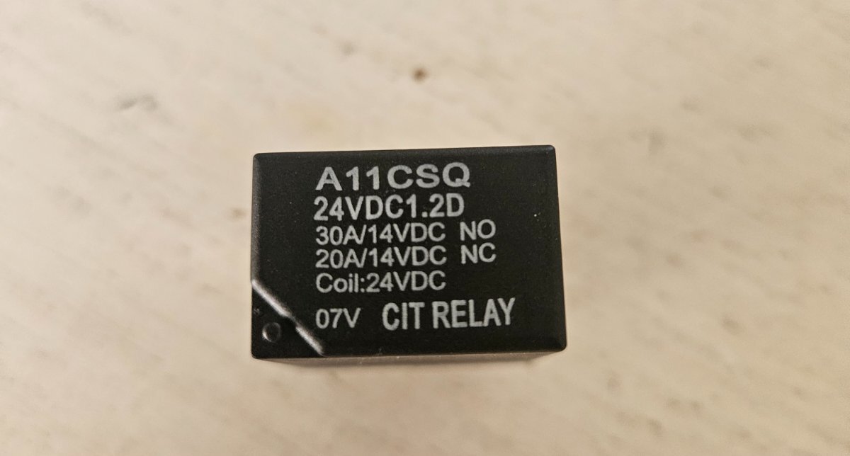

motoguzzikc Posted April 16, 2024 Author Posted April 16, 2024 @p6x the veglia failed years ago and dad replaced with with an Equus. This Amazon link appears to be the same tach. Equus 8068 3-3/8" Tachometer (DIS), White with Aluminum Bezel https://a.co/d/6TEqrOT @docc my new relays from have arrived by digikey but it appears they sent the wrong ones. The last oder I received said 11v CIT RELAY at the bottom where as these say 07v and they are blowing my 10a ignition switch fuse every time I turn the bike on. Looks like I'm going to ha w to let the problem set for a few days while I wait for new relays again. 1
docc Posted April 16, 2024 Posted April 16, 2024 On 4/16/2024 at 8:02 PM, motoguzzikc said: @p6x the veglia failed years ago and dad replaced with with an Equus. This Amazon link appears to be the same tach. Equus 8068 3-3/8" Tachometer (DIS), White with Aluminum Bezel https://a.co/d/6TEqrOT @docc my new relays from have arrived by digikey but it appears they sent the wrong ones. The last oder I received said 11v CIT RELAY at the bottom where as these say 07v and they are blowing my 10a ignition switch fuse every time I turn the bike on. Looks like I'm going to ha w to let the problem set for a few days while I wait for new relays again. Expand Edit: As noted by @Speedfrog, you had the wrong/24V product listed in your post: https://www.digikey.com/en/products/detail/cit-relay-and-switch/A11CSQ24VDC1-2D/12502798?s=N4IgTCBcDaIIIEYEGEDKBFMAWAagEWQQDow8ACEAXQF8g [Welldone, @Speedfrog!] 1 1
motoguzzikc Posted April 16, 2024 Author Posted April 16, 2024 @doccthat is indeed what I order, they just sent the wrong thing unfortunately. 1

Speedfrog Posted April 16, 2024 Posted April 16, 2024 On 4/15/2024 at 10:45 PM, motoguzzikc said: Docc - based off pass posts I read on here concerning relays I ordered a 10 pack of CIT A11CSQ24VDC1.2D from digikey. . . . Expand On 4/16/2024 at 8:10 PM, docc said: You had the right wrong product listed in your post: https://www.digikey.com/en/products/detail/cit-relay-and-switch/A11CSQ24VDC1-2D/12502798?s=N4IgTCBcDaIIIEYEGEDKBFMAWAagEWQQDow8ACEAXQF8g Expand These are 24volts relays - diode protected . . . . The ones to get for our V11s from Picker Components >> PC782-1C-12S-R-X https://www.digikey.com/en/products/detail/picker-components/pc782-1c-12s-r-x/12352866 1 2
motoguzzikc Posted April 16, 2024 Author Posted April 16, 2024 On 4/16/2024 at 9:08 PM, Speedfrog said: These are 24volts relays - diode protected . . . . The ones to get for our V11s from Picker Components >> PC782-1C-12S-R-X https://www.digikey.com/en/products/detail/picker-components/pc782-1c-12s-r-x/12352866 Expand @docc I was wrong in saying that. I believe the relays that were just delivered are all 24v wlWhen comparing my original order from digikey that I bought last month and the order that showed up today they are not the same relay The first set of relays I was sent 12VDC1.2R But the new relays are marked as 2VDC1.2R 1
motoguzzikc Posted April 16, 2024 Author Posted April 16, 2024 Oh man, egg on my face. After looking at my order confirmation again, I accidentally order the 24v relays🤦 1
Speedfrog Posted April 16, 2024 Posted April 16, 2024 On 4/16/2024 at 9:18 PM, motoguzzikc said: But the new relays are marked as 2VDC1.2R Expand If you are referring to your second picture, they are indeed 24volts relays >> 24VDC1.2D 1 1
