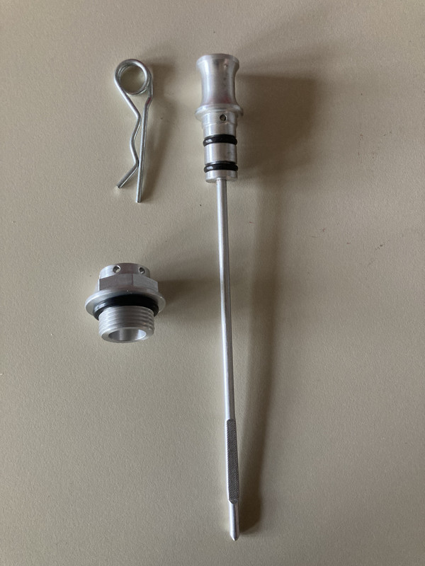

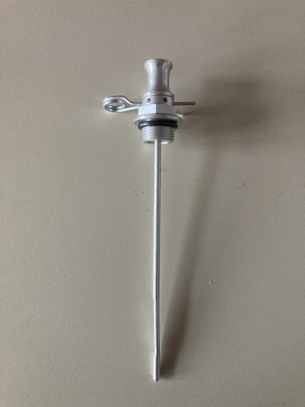

audiomick Posted May 22, 2024 Posted May 22, 2024 There's a bloke on the German forum that makes pull-out dipsticks for Guzzis. A screw in plug for the filler hole with a dip-stick through the middle secured by a locking pin. Made of metal, and flat in the relevant measuring area. I reckon I will get one of those (likely one each for all three Guzzis), and the suggestion to make a mark on it just under the Roper Plate in the case of the V11 is very likely to be used.

pete roper Posted May 23, 2024 Posted May 23, 2024 12 hours ago, audiomick said: There's a bloke on the German forum that makes pull-out dipsticks for Guzzis. A screw in plug for the filler hole with a dip-stick through the middle secured by a locking pin. Made of metal, and flat in the relevant measuring area. I reckon I will get one of those (likely one each for all three Guzzis), and the suggestion to make a mark on it just under the Roper Plate in the case of the V11 is very likely to be used. Just buy a Stelvio one and mark the stick appropriately. 2 1
audiomick Posted May 23, 2024 Posted May 23, 2024 Thanks for the tip Pete. I wasn't aware that Guzzi had ever made a sensible dipstick. I still might buy one or three from Meinolf, though (no, not him, the other Meinolf...) because his work is really quite pretty, and he's a nice bloke into the bargain. And he also makes them to fit the small blocks, i.e. suitable for my Breva 750 and my V35 Imola. Incidentally, he (the Meinolf in question) has a V65 track bike modified to a mono-shock rear suspension. It looks a bit "utilitarian", but the longer you look at it, the more stuff you discover that he has modified. Cool bike. Here are a couple of pictures of his dipstick. 2 2
