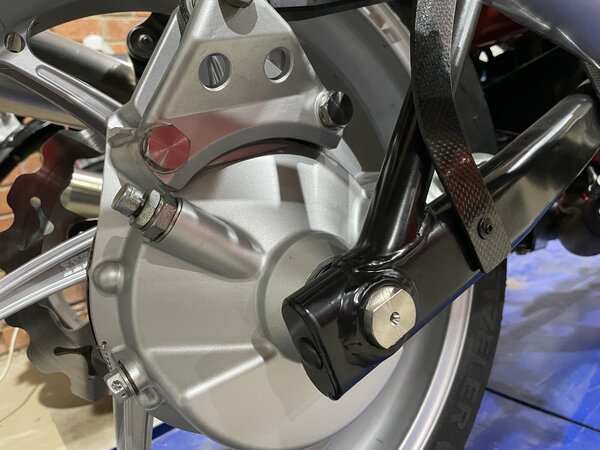

Lucky Phil Posted May 29, 2024 Posted May 29, 2024 In my continuing journey to improve my machining skills I decided to make replacement Titanium bolts and washers that mount the rear bevel box torque arm bracket to the bevel box. One bolt and two washers done one bolt to go. I've also got enough Ti stock to make a replacement bevel box torque arm bolt as well. Phil 9

Lucky Phil Posted June 1, 2024 Author Posted June 1, 2024 Machined up the other special bolt for the rear drive. 4
