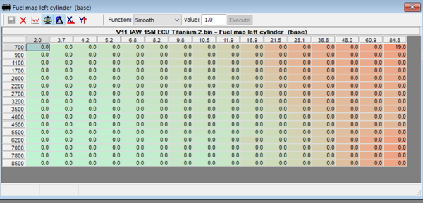

Lucky Phil Posted June 13 Share Posted June 13 7 minutes ago, DucatiGuzziIndian said: Gentlemen Wanting to install my recently purchased Mistral mufflers but need some advice on the correct course of action regarding a tune. I've read the near 50 pages on tunes using Guzzidiag, etc but I have neither the time, ability nor inclination to become a temporary computer geek just to screw around with it. What's the consensus on the easiest way for a non tech person to get a correct tune for the Mistrals' Any assistance is hugely appreciated. No "correct tune" required. Just bolt them on and ride it on the stock factory map. Phil 4 Link to comment Share on other sites More sharing options...

Lucky Phil Posted June 13 Share Posted June 13 10 hours ago, GuzziMoto said: I don't completely agree with Phil, but I do agree that I would start with what he said and see how it runs. It is certainly possible that it will be more then satisfactory with Mistral's and the stock map. Unless it is not, I would leave it like that. If it is not satisfactory that way, I would start with the standard tune up procedure to make sure your baseline is right. If it is still not to your liking only then would I start messing with the tune. And to mess with the tune you can either load a map from one of the maps already made, which is what I would do, or you could come up with a custom map, which I would not do. But I would bolt them on and see, first. I have had 5 different muffler combo's on my bike as a 2 valver and 2 different cross overs and the bike ran well/exactly the same on all of them. Below is the "delta" map of a 2000 V11 Sport main fuel map compared to the factory "Titanium" main map. So you know the expensive new ECU they supply with the Titanium mufflers same as Ducati used to do with the approved Termi exhausts. Note there is zero difference in the fuel map. Ducati used to do a similar thing, sell you an $1800ecu with Termi mufflers and just add 3% fuel everywhere which wasn't necessary. My 1198 has a Full Ti Akropovic exhaust and what do Akra say to do when you fit their system? Nothing. Fit it and ride it which I have done and it's fine. You want to get the absolute maximum out of a set of mufflers or exhaust combo on pretty much any bike then you'll need to map it but for 99% of bikes 99% of the time it isn't necessary in my experience. You might need to tweak the Co and the air bleeds a little but other than that install and ride. 5 2 Link to comment Share on other sites More sharing options...
Pressureangle Posted June 14 Share Posted June 14 Phil's spot on. Here's the thing about exhausts; unless the system you are replacing is poorly designed and the system you replace it with is very well designed, they have near zero effect on engine tune. 99.9% of exhaust effect on fueling happenss in the headpipes and crossover, if there is one. After that it's sound mitigation. Even then, a quiet muffler has very little effect except at WOT. The main advantage to an exhaust change is weight, particularly if it has a catalytic converter. And of course we all love the boom. 2 Link to comment Share on other sites More sharing options...
