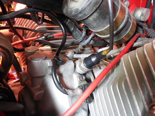

docc Posted June 13, 2024 Posted June 13, 2024 @Drahchir, if the leak is on the left a common source is the crank position sensor. This is the sensor in front of the cylinder with the two hex drive fasteners. Sometimes, just snugging up the fasteners is enough to address the leak. Otherwise, it uses a small Viton O-ring (#112 SAE or metric equivalent). Be mindful of the thin spacer as it indexes the cam timing. These sensors might also leak through the wiring leading me to coat mine in JB Weld epoxy many years ago. 2

Randy Posted June 15, 2024 Posted June 15, 2024 Same leak on mine. The breather hose checked out fine. I sealed the TPS with a small amount of RTV to see if that's the source. I have a timing cover gasket on hand if it turns out to be the problem. 3
docc Posted June 16, 2024 Posted June 16, 2024 On 6/15/2024 at 4:46 PM, Randy said: Same leak on mine. The breather hose checked out fine. I sealed the TPS with a small amount of RTV to see if that's the source. I have a timing cover gasket on hand if it turns out to be the problem. Expand Rather than the TPS (on the right side throttle body, which cannot leak oil), do you mean the cam/timing/phase sensor on the left, ahead of the cylinder, @Randy? 1
guzziart Posted June 17, 2024 Posted June 17, 2024 I had both leak... first it was the cam timing sensor so I replaced it after numerous attempts with new orings, JB weld the top & cable coming from it, etc. The other leak was the cam chain cover on the right side of engine. For the cam chain cover gasket, I went with "genuine" guzzi composite. The other gaskets I had bought (aftermarket composite & paper) were not cut imo properly...gasket bolt holes did not line up with bolt holes in the cover without distorting the gasket. Yeah, I know MG doesn't make their own gaskets...just saying the MG offering lays flat & all the holes line up as they should...no distortion. Also, I think I read somewhere that while the original was paper, it was superceded to a composite around 2005. Anyway, the MG composite gasket went on dry, no sealer, no leaks. Art 1
Randy Posted June 17, 2024 Posted June 17, 2024 On 6/16/2024 at 8:13 PM, docc said: Rather than the TPS (on the right side throttle body, which cannot leak oil), do you mean the cam/timing/phase sensor on the left, ahead of the cylinder, @Randy? Expand Yup. 1 1
