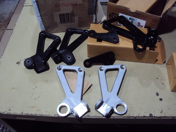

footgoose Posted June 14, 2024 Posted June 14, 2024 Here are the Ti kit hangers assembled with adapters. the welded on nut is not necessary, just convenient 2 1
footgoose Posted June 14, 2024 Posted June 14, 2024 silver is from an early (94-99) Sport, next to the Ti kit installed, with adapter 1
footgoose Posted June 14, 2024 Posted June 14, 2024 pencil outline of adapter and how it sits when combined left hole to right top hole is 70mm, or same as mount bracket welded to the frame left hole to right bottom hole is 60mm or the same as the high mount bracket right bottom hole to right top hole is 23mm, which gives the desired angle. adapter is 6mm flat steel. the cool cutaway at the bottom is for looks and not needed. 2
footgoose Posted June 14, 2024 Posted June 14, 2024 how it looks (without adapter) overlaid on a stock 2003 hanger for comparison let me know if I have forgotten anything. measurements are not 'machinist' accurate, but it'll get you there 3
