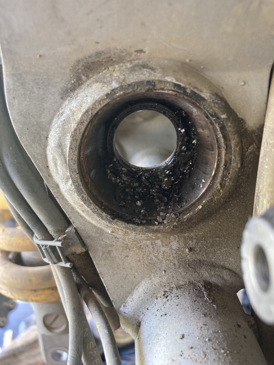

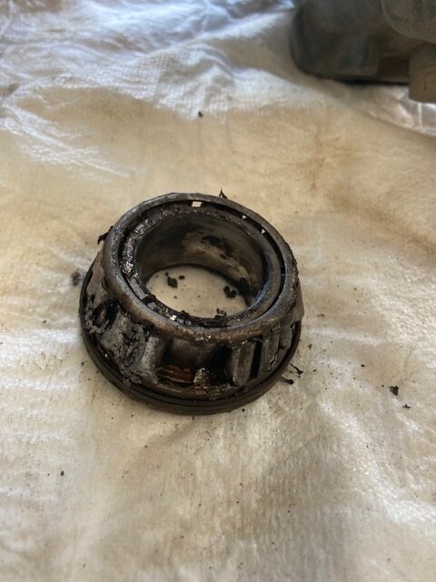

pete roper Posted June 20, 2024 Posted June 20, 2024 They’re better than many but I still wouldn’t put them back in. What are the outer races like? Not like these I hope? 1
activpop Posted June 20, 2024 Author Posted June 20, 2024 Ok, the dry as a bone was a little exaggerated, but there was no grease to be found. They looked lightly oiled at best, which to me is dry. The should be lathered in grease. The races seemed fine as the bike has less than 6k miles on it. The needle bearings on the three point shock connection were void of any grease also so they got smeared too. Next is the Griso. About the same mileage, so hopefully no damage.
activpop Posted June 20, 2024 Author Posted June 20, 2024 @pete roperHow many miles on those? Somebody didn't get the memo.
pete roper Posted June 20, 2024 Posted June 20, 2024 I can’t remember exactly. Probably about 30,000km.
