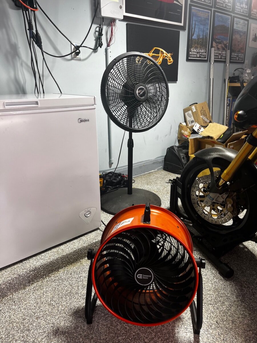

PJPR01 Posted July 1 Share Posted July 1 Good work P! You’re burning at least 10,000 calories working under these conditions!! For me the only way it’s tolerable to work in the garage these days in this 100+F heat…I’m seriously considering installing a split unit!! Willing to take recommendations on good brands if anyone has one installed! 1 Link to comment
