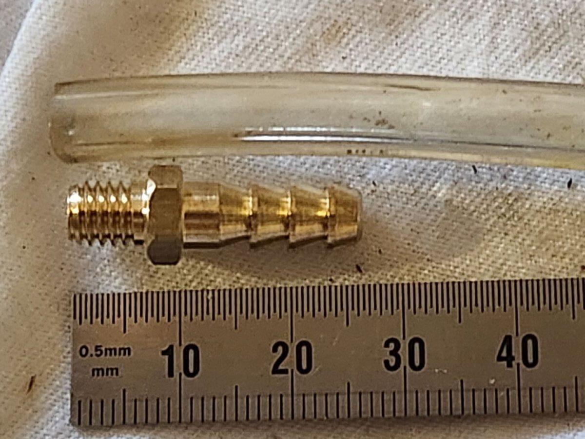

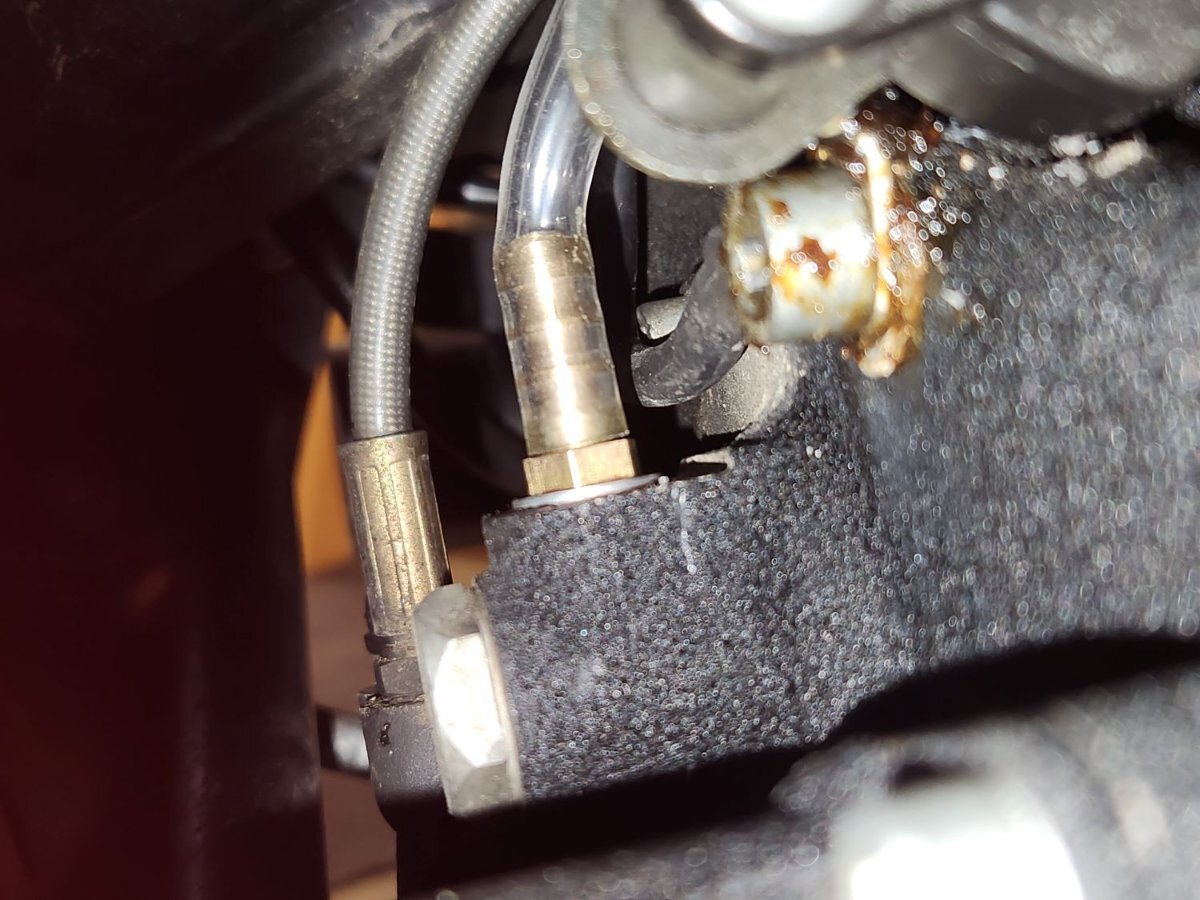

MartyNZ Posted July 13, 2024 Posted July 13, 2024 @cash1000 had foaming in his gearbox oil. He drained and refilled a few times before it stayed clear. We thought that it may be because of water getting into the oil, and the only path for water seemed to be the vent, which is in line with spray from the rear wheel. We both fitted a remote vent hose to avoid this. The vent plug thread is M6 x 1 mm. 2 1
